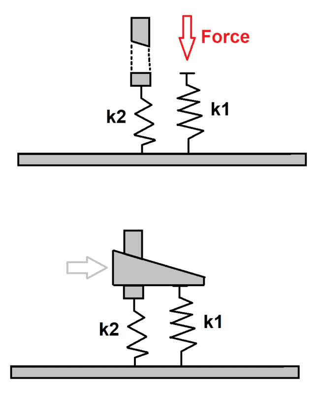

I have an interesting problem here from the real world, it's a design i am working on.
So I have an object that is pressed by an hydraulic press with 50kN, let's call it F_before. Then I drive in a jig to fixate it. But the part that holds the jig has a limited stiffness. Hence if I release the hydraulic press the system will bounce up and the force in the system will be less than 50 kN, but how much?
The way I see it the springs are in series and I can use the conservation of spring energy to find the ratio between F_after and F_before.
F_after/F_before = sqrt(k2/(k1+k2))
Is this correct? The square root in the solution looks kinda odd to me.
  • Two-panel schematic of a spring setup on a base plate: top panel shows a block pressed down by a force arrow, with springs k1 and k2 beside each other; bottom panel shows a tilted wedge clamp with a horizontal arrow, springs k1 and k2 beneath it.

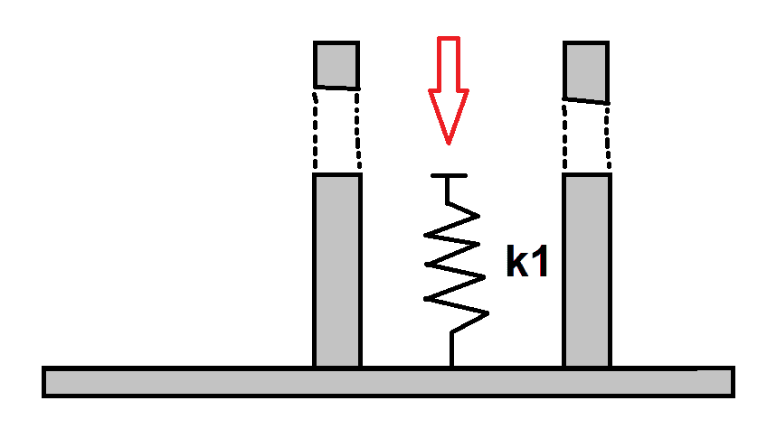

In reality the spring k2 is a bus with limited stiffness that goes around k1. The jig goes through the bus supporting against the inner spring on the left and the right sides. see picture
I think the jig and any deformations in it can be considered part of spring k2 once I transfer my conceptual design to a finite element program.
But for now I am trying to get a more basic understanding of my design.
  • Diagram of a block on two vertical posts above a base plate, with a red downward arrow and a spring labelled k1 in the centre between the posts; dashed lines show the block's offset position.

Yes indeed. Because the springs are in series. But the question is how much remains of the tension/compression force after the jig is placed and the press is released. It should be less that the 50 kN the press applied
I also don't think the root should be there.
Consider the force over jig displacement (relative to the release position) graphs of the two springs:
spring_1: intercept = F_before, slope = -k1
spring_2: intercept = 0, slope = k2
F_after
is where they intersect after some jig displacement d:
(F_before - F_after) / d = k1
F_after / d = k2
Solving for F_after leads to:
F_after = F_before * k2/(k1+k2)
I agree with @A.T.
