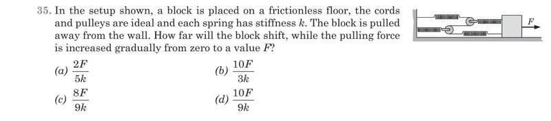

In the setup shown, a block is placed on a frictionless floor, the cords and pulleys are ideal and each spring has stiffness k. The block is pulled away from the wall. How far will the block shift, while the pulling force is gradually increased from zero to a value F
Pic below.

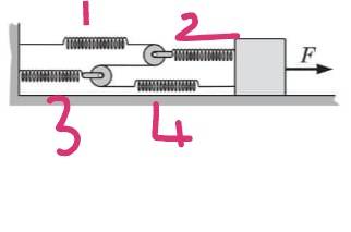

##F_s = Kx##
So I labelled all the springs from 1 to 4. Since the force is gradual, at equilibrium :
##F = k(x_2+ x_4) - - - - (1)##
Now we need to relate the different extensions of the springs:
##kx_1 = kx_4## (same string)
##x_1 = x_4 (2)##
##kx_2 = 2kx_1## ( ideal pulley)
##x_2 = 2x_1 (3)##
## kx_3 = 2kx_4## (ideal pulley)
##x_3 = 2x_4##
Now I came to these equations by displacing each spring and assuming how much the pulleys would move. I'm not sure of how the string length would be distributed over the system.
I assumed that as spring-1 moves ##x_1## Half of this would be carried over to spring-2 and so on. I would like to know whether this is the right approach, and if so why?
Then I proceeded to equate ##(1)## with ##(2)## and ##(3)##:
## F = k(3x_4)##
Thus,
##x_4 = F/3k##
Now this part is where I'm absolutely shaky:
Displacement of block ##x = x_1/2 + x_2##
And so equating everything we get:
##x = 5{x_4}/2##
Therefore,
##x = 5F/6k##
But the given answer is ##10F/9k#
So where am I going wrong? And is there any way to easily deduce what would happen in such systems?
Thanks in Advance!

Consider the three horizontal sections of string.
What is the relationship between the changes in lengths of the top and middle section and ##x_1## and ##x_3##?

It is correct. Just consider the forces on the block.
Null_Void said:
The change in length of the top string is equal to the elongation of spring-1
while for the middle section it is equal to twice the elongation of spring-3
No, the pulleys will have moved.
Call those three length changes ##y_1, y_2, y_3##.
What is the relationship between ##x_1, y_1, x_2## and ##x##?
Similarly for ##y_2, y_3##.

##y_1 = - {x_1}/2##
##y_2 = +{x_1}/2 - 2x_3##
##y_3 = +2x_3##
I'm a bit confused about the displacement of the block. Since both the springs are connected to the block, I should get two equations for the same displacement ##x## right? One equation involving spring-1 and spring-2 and the other involving the rest. Is this the right approach?
Null_Void said:
##y_1 = - {x_1}/2##
##y_3 = +2x_3##
I don't know how you obtain any of those. I did mention that x should be in the equations.
There are three. Follow through the three paths from end to the other. Each must add up to x.
I assumed that the pulley moved a distance ##l_1##, therefore the string must move ##2l_1## and thus this must also be equal to the spring's elongation:
##l_1 = {x_1}/2##
Displacement:
##x = l_1 + x_2##
##x = {x_1}/2 + x_2##
I'm still getting the same equation. Where am I going wrong?
For springs 3 and 4:
##x = 2x_3 + x_4##
I can't find the third equation you mentioned. I don't know how to account for the middle section and equate it to ##x##
I can see that there will be changes to the lengths of the three sections, but I'm not sure about how to find a relation between them.
For section-1:
If spring 1 extends by ##x_1##, string 1 should slack by ##x_1## and therefore the pulley must displace by ##{x_1}/2##
Net change is ##x_1##
Section-2:
From first pulley's extension, the length must increase by ##x_1## and if spring-3 expands by ##x_3## then net change is:
##x_1 - 2x_3##
For section-3:
##2x_3 + x_4##
Where have I gone wrong? Can you drop some more hints?

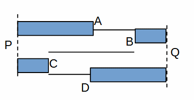

@Null_Void, it looks like you are at a bit of an impasse. You've clearly put some effort into this so I’d like to add a little to what @haruspex has already said.
In the simplified (and not to scale) diagram below, horizontal lines are horizontal string-sections; blue boxes are springs.
Working from left to right you should see that you can write three equations, the first being:
##\Delta PQ = \Delta PA + \Delta AB + \Delta BQ##.
(Using symbols from previous posts: ##x= x_1 + y_1 + x_2##.)
See if you can write the other two similar equations. (Note that two of the three equations are effectively identical because of symmetry.)
Of course, since string length is constant, you have the additional equation:
##\Delta AB + \Delta BC + \Delta CD = 0##
(Using symbols from previous posts: ##y_1+ y_2 + y_3 = 0##.)
The algebra is much simpler than it looks because you already know the value of extension for each spring (your Post #1).

Hi @Null_Void, take a step back.
In post #1 you (correctly) found ##x_4 = \frac F{3k}##. For neatness/conciseness, represent the quantity ##\frac F{3k}## by ‘##e##’.
First, express the values of ##x_1, x_2, x_3## and ##x_4## in terms of ##e##. (Refer back to Post #1.)
Next, write out the ‘3 equations’ for the total extension (##x = \Delta PQ)## as follows:
##x=## some expression containing ‘##e##’sand ‘##y_1##’
##x=## some expression containing ‘##e##’s and ‘##y_2##’
##x=## some expression containing ‘##e##’s and ‘##y_3##’
Simplify these. Note the right hand sides of the 3 equations are equal (as they all equal ##x##).
Remembering ## y_1+ y_2+ y_3=0## can you find ## y_1, y_2## and ##y_3## each in terms of ##e##? Remember, length-changes can be positive or negative.

Writing all the elongations in terms of e:
##x_1 = e##
##x_2 = 2e##
##x_3 = 2e##
##x_4 = e##
So like you pointed out, we get three equations:
##x = x_1 + y_1 + x_2##
##x = 3e + y_1##
##x = x_2 + y_2 + x_3##
##x = 4e + y_2##
##x = x_3 + y_3 + x_4##
##x = 3e + y_3##
##y_1 + y_2 + y_3 = 0##
We have four equations and four unknowns, this solving these equations gives us the answer ##x = 10e/3 .
I like how this method gets rid of the entire need to think about the pulley, thus making it much more simple.
Yes. But it doesn't look like you've actually done the working for yourself!
Because of the symmetry, the equations greatly simplify since ##y _1 = y_3## (can you see this?) Make sure you solve the problem to completion.

b) Worried a bit about how to deal with changes in the separation of the pulleys.
c) Drew a diagram in a simplified form (i.e. the one in Post #9) and marked length-changes on the diagram. To quote my old physics teacher: “Always draw a diagram.”.
d) Saw that if the top string’s length changes by ##\Delta L##, so must the bottom string’s length. And as a result, the middle string’s length changes by ##-2\Delta L##.
e)Looking at the diagram, noted that the change in the top (or bottom) path length must equal the change in the middle path length giving ##e + \Delta L + 2e = 2e -2\Delta L + 2e##. Voila!
My general advice would be to get as much practice as possible and always draw a diagram!
