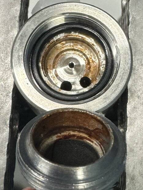

Stainless steel valve does not like HCl… help!
Not my issue directly, more a case of relaying the problem, but here goes.
My girlfriend works for a company that makes bioanalytical units, and is part of their validation team in particular. They’ve started running into an issue with a stainless steel solenoid valve where it is, for lack of a better description, rusting. It’s producing a slurry or sludge that is definitely iron oxide color, and there’s visible pitting on the inside of the unit. Some tests have conclusively tied the issue to exposure to hydrochloric acid that’s used as part of the cycle in the analysis unit. All attempts to reach out to the vendor who makes the valves with questions about the metallurgy of the valves have failed, and the team is scratching their heads over it.
Is there any way to determine what is going on at a chemistry level to cause it, or to find ways to protect the valve from this corrosion?
What is the grade of the stainless steel?
304 is easier to machine, while 316 is designed to survive in the presence of chlorine and seawater.
Is the colour due to corrosion and pitting of the surface, or deposition onto the surface?
The sludge deposits on the plunger side of the valve and the spring and is easily removed with wiping. The body of the valve undergoes pitting.

That’s the weird bit. She tested a brand new valve in HCl only and it manifested in about three days. No other chemicals were run through it and it still happened. Hence why I said it’s conclusively tied to the acid. And it’s only the valve body, not the plunger or spring.
I did ask about dissimilar metal corrosion early on, but I seem to recall the testing included just dunking the parts in a beaker of 0.1 molar hydrochloric acid and leaving it for a couple days and then getting the same result. I’ll double check with her on that tonight, though.
The spring and plunger may be SS grade 316, made from wire, or ground from stock bar. 316 work hardens instantly when being cut, so is best ground to profile, with a carbide grit wheel.

Finally, some progress!
She got a response with actually useful data…
“The valve body is 303 stainless steel, the plunger is 430FR stainless steel with a 304 ss spring.”
Soooo… yeah, that sounds like a case of needing a new valve if they want to run HCl?

Well, the adventure into metallurgy has come to a close. New valves have been ordered, and I quote:
“Based on the required pressure, they recommended a metal valve with nitric passivation.”
They’re not expecting to receive them for a month or so, as they’re manufactured on demand, but it sounds like they’re not going to cost much more than the original stainless ones.

With regard to the alloy 303 used for the body of the original valve ...
Penn Stainless Products advise ... https://www.pennstainless.com/resources/literature/
Alloy 303 has good resistance to mildly corrosive atmospheres, but significantly less than alloy 304. When additional sulfur is added to improve machinability, it can often slightly reduce corrosion resistance. Like other common austenitic stainless steels, it is subject to corrosion cracking in chloride environments above 60ºC.
Alloy 303 should not be exposed to moist, marine environments as it is subject to rapid-pitting corrosion and a rust film will tend to form.
Chloride ions may undermine the oxide developed by 'nitric passivation'.
One should also be aware of any crevices in the fit up, which could lead to crevice corrosion - which may occur in the presence of chlorides, as well as contact with a dissimilar metal (galvanic coupling).

I don't believe any common stainless steels (304/316/18-8......) will matter much. Not knowing the contact time, temperature, or concentration makes this difficult.
First thought is to maybe going to a higher nickel alloy will help. Seems Carpenter 20, and one of the Hastelloy's are alloys worth consideration. My experience is HCl is very difficult to deal with and doing so will involve fairly unusual materials.
Have you considered composites, or composite (plastic, like PTFE/PFA) lined equipment? These will work, but you can get hydrogen migration and blistering through the composite coating.
