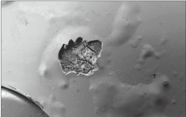

Both Aluminium and stainless rely on an oxide layer to prevent further corrosion, covering the metal will initially prevent the metal being attacked, but also has the disadvantage of preventing the oxide layer from maintaining itself.
This means that when the coating inevitably fails, it can corrode quite aggressively, esp if water for example is able to get in between the coating an metal and create an oxygen starved environment, now the oxides can't build and corrosion happens at an accelerated rate (more generally known as crevice corrosion: https://en.wikipedia.org/wiki/Crevice_corrosion ).

Thank you, I had thought of something similar to that as I've seen it happen before to steel. I will not coat it then since coat lasts maybe a year max.

This was very helpful to me. I decided to not use a coating. I have another question for you and the rest of the people here. With galvanized steel that is for outdoor use, that is also POWDER COATED at a high temp and bonded properly, will it have this same effect (crevice corrosion) or will it not because the powder coat material is meant to stop corrosion?
I don't know if powder coating actually has a similar effect like stainless steel, aluminum, or zinc as far as the oxidization process or not but would like to learn more about it.

I have had very good outdoor longevity with galvanized steel painted with alkyd enamel. No crevice corrosion.
