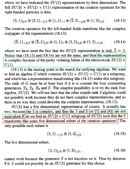

I'm wondering something about what it says here. Specifically I am trying to understand the motivation for the part that's in the red box. I have also highlighted earlier parts in green boxes that I suspect might be related, but I don't quite understand.
Printed page of a textbook on particle physics: equations 18.13 to 18.16 listing SU(3) x SU(2) x U(1) representation decompositions, with green and red boxes highlighting text about complex representations and the SU(2) x U(1) subgroup of SU(5).
So it wants to get the SM decomposition of the [itex]\textbf{5}[/itex] by choosing from constituents of the equation (18.13) that combine to form a 5-dimensional subset. Fair enough. What I don't understand is the [itex]SU(2) \times U(1)[/itex] part. Why must the [itex]\textbf{5}[/itex] incorporate that specifically? Why not require, say, [itex]SU(3) \times SU(2) \times U(1)[/itex]?
Anchovy said:
Why must the 5\textbf{5} incorporate that specifically? Why not require, say, SU(3)×SU(2)×U(1)SU(3) \times SU(2) \times U(1)?
The multiplets in ##(18.15)## aren't a subgroups of ##SU(3)\times SU(2)\times U(1)##?
