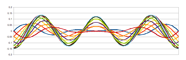

Taking attenuation into account, I get the following simulation:
This shows the middle three wavelengths from two speakers placed five wavelengths apart. The 11 curves represent the pressure pattern at equal time intervals across half a period (endpoints included). For the other half period, reflect about the X axis.
No point is a perfect node, and the further from the centre the less perfect. Even so, it does appear that the relative minima are at the same places as for no attenuation.
@hutchphd , do you have an easy way of proving that? The algebra looks messy to me.
