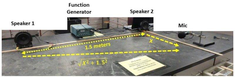

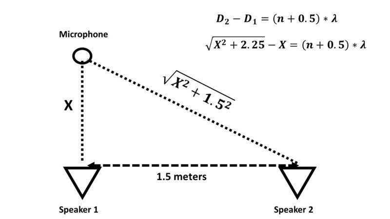

Hello,
Many of you are familiar with the homework problem that goes like the below, and though straightforward to solve in most general physics homework sets, I need to help getting it to work, which is not so easy in real-life.
Consider two speakers separated by 2.0 meters. Find the points along the path from one of the speakers where destructive or constructive interference occurs. The frequency is 1000 Hertz.

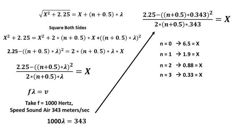

The picture and calculations are attached in the jpeg “Slide 1 and 2" for Problem and Solution.
I reproduce here the N’s (Dest), M's (Cons) and X’s (position from first speaker on a line in meters) for which destructive interference should occur.
N X where Dest occurs M X where Cons occurs
n = 1 --> 1.9 meters = X m = 2 --> 1.3 meters = X
n = 2 --> 0.88 meters = X m = 3 --> 0.6 meters = X
The jpeg “Setup” shows the equipment I use and I list the equipment below.
two Pasco 60 Watt Speakers
Both speakers are driven by an AFG1022 Textronix Function Generator, with the intent to drive them at the same time
The microphone is USB, Fifine Company
The waveform software is “Audacity.” which is freely downloaded

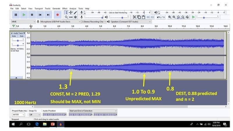

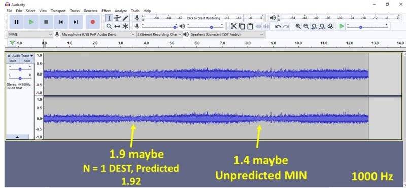

Bascially, I move the microphone along the direction “X” in the photo “Setup.jpg”. I move it slowly so that is why the waveforms look stretched out. I move the microphone continuously and slowly, but only barely can I get discernible humps and valleys as maxes or mins. I did also try moving it quickly, but my results were no better (not shown). Lots of times, the points of destructive or constructive interference don’t match very well.When I move the microphone to the X values above, you can see the waveforms of what I get in the following jpegs. “desNeq1.jpg” shows that, when I moved the microphone to 1.9 meters, I got a hint of the destructive interference that I should. However, when I moved the microphone to 1.4 meters, I got a destructive interference I did not predict. These waveforms are not very clear however.
In the jpeg “ConsANDdest.jpg”, you can see that, for constructive interference predicted at 1.3 meters, I actually measure a MIN but not a MAX, as I was supposed to. When X = 1 meter or so, I got another unpredicted MAX. For X = 0.8, I do predict a MIN there, but what I measure is barely convincing.
How could I change my situation/setup so that I can find easily the points of constructive or destructive interference for this problem? I checked my math several times, and I am certain the calculations are right. Would the changes be a lot or a little, expensive or cheap in equipment? What is making my data so unclear? Could reflections in the room itself cause a problem and should this be done outside? I had assumed that since this homework problem appears so often in general, lower-division physics classes, it would be easy to reproduce. Certainly not the case and I’m looking for suggestions on how to improve this, if it can be.

In my experience too, interference experirments with two speakers are somewhat disappointing. My best results were at 3.5 kHz (λ = 10 cm) with two small audio speakers, holding one of them in my hand for easy displacement, and detecting interference maxima and minima by ear. The distance between successive maxima was about 10 cm, in the axial direction and in the lateral direction.
I think the problem of interference experiments with two speakers is that multiple mirror images of the sound sources appear due to reflection of sound on hard surfaces, such as a table and the case of each speaker. Due to the many sources there is no completely destructive interference in the minima, and the location of minima and maxima is more complicated.
spareine said:
I think the problem of interference experiments with two speakers is that multiple mirror images of the sound sources appear due to reflection of sound on hard surfaces, such as a table and the case of each speaker. Due to the many sources there is no completely destructive interference in the minima, and the location of minima and minima is more complicated.
Agreed. There was a very nice setup at the Exploratorium in San Francisco many years ago with floor-standing 1m high speakers placed about 15m apart, and the sound was around 600Hz, IIRC. The beats were very apparent when you walked in one direction, and you could walk at some rate in the other direction and not hear any beats.
The two speakers were fairly well isolated in the middle of a carpeted floor on the 2nd floor, without any reflecting objects nearby (except people walking around).

Constructive interference "only" doubles the amplitude at best. Less in your set up if the speakers are somewhat directional. So any reflections that "fill in" the areas of destructive interference can significantly reduce the difference in volume between the two locations. Try it outdoors if weather permits.

Re the unexpected node/destructive interference at 1.4m...
The wavelength of 1000Hz is about 0.34m at 20C. I noticed that if you substitute x=1.4 into the equation for the path difference
Sqrt(X2 +2.25) - X
It works out at about 0.65 or approx 2λ
But that means that n in (n+0.5)λ would have to be 1.5 which is not correct for a node (destructive interference).
So I wondered if both speakers are in phase? It's very easy to accidentally swap the connections over so one is going in when the other is going out.
Worth checking if not already done but I suspect that if they weren't in phase you wouldn't get a node at 1.9m.
