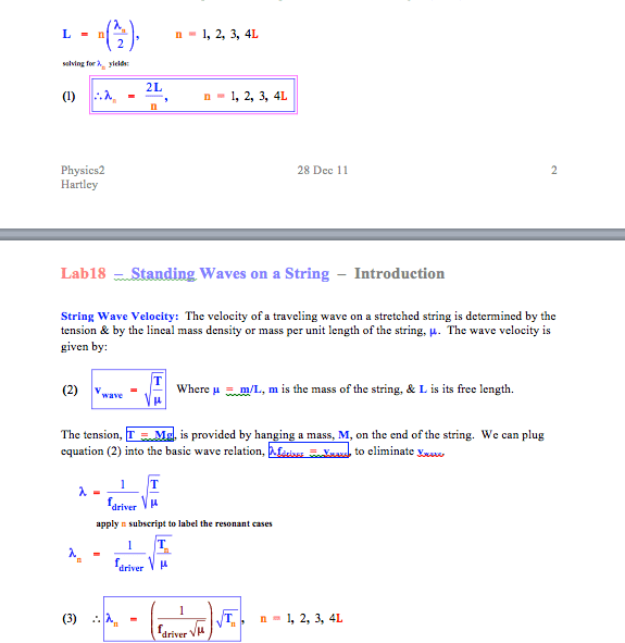

The discussion focuses on the derivation of the wave equation for a string under tension, specifically addressing the relationship between wavelength (λ), length (L), and frequency (f). The key formulas mentioned include λ = 2L/n and f = nV/2L, where V represents wave speed. The participant successfully utilized Newton's laws of motion (F=ma) to understand the derivation, confirming the connection between tension and wave behavior in strings.

Please see the picture.
How do they get this derivation?
I know that lambda = 2L/n and f = nV/2L so I can somewhat rearrange it myself, but I do not know where the square root is coming from.
