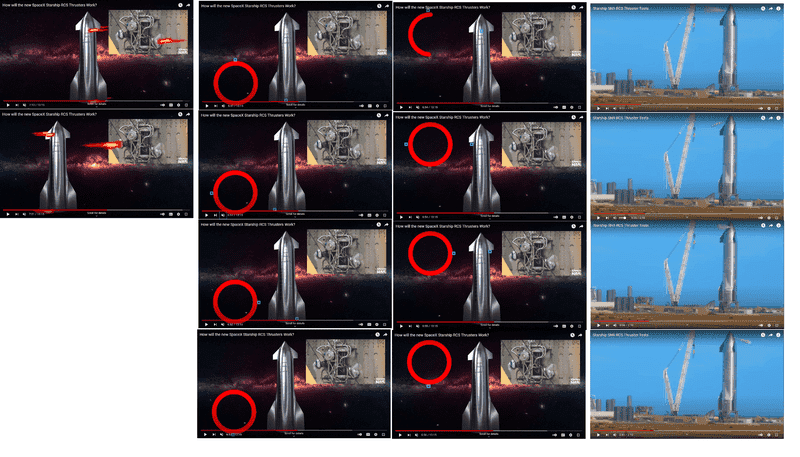

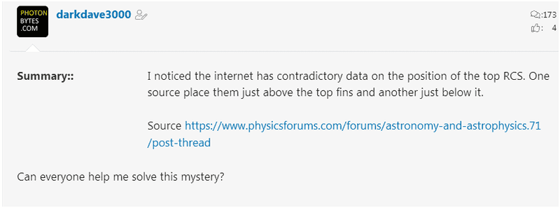

I noticed the internet has contradictory data on the position of the top RCS. One source place them just above the top fins and another just below it.
Source https://www.physicsforums.com/forums/astronomy-and-astrophysics.71/post-thread
Can everyone help me solve this mystery?
Starship has 8 sets of RCS thrusters, 4 at the top and 4 at the bottom near the base. The 4 at the top some youtube videos show them above the top fins:
Nitrogen RCS test:
But some other videos show them below the fins:
Are they both right because the Nitrogen ones are ment to be above the fins while the hot methane and oxygen gas piston version below the fins?
Or is the second one wrong and both types are supposed to be above the top fins?
Also can I assume that the COG is between wherever the top and bottom RCS are? Wont they shift?
Lastly does the top and bottom RCS need to work together or can the top fire without the bottom and vice versa to rotate the ship around the COG?
Check attached photo.

They use cold gas thrusters now but plan to switch to hot gas thrusters in the future - using the same fuel as the engines to make refueling simpler (especially on Mars). It's possible the location has changed in the past and/or will change again in the future.
For SN9 and SN11 and SN15 they were above the fins. Rotating the ship works with a single set of thrusters but then you change your orbit slightly in addition.

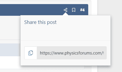

DaveC426913 said:
I think it is a PF forum glitch that does that. I've seen it several times, but have not been able to figure out what causes it...
Just a copy&paste error if you take the URL from the wrong tab when starting a thread (i.e. from the tab where you start the thread).
Yeah. The OP would do better with this:
