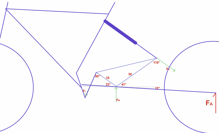

I'd love for you to look over them. :-)
Here's how I calculate the vertical force up (FM) on the swing arm, which would then have the shock angle taken into account as applied to the bottom of the shock.
The free body diagram would look like this:
Let's just say FR = 100N (cause I forgot we already calculated 980N)
I find FM using the torque equilibrium about FL.
FR(cos12)(495) = FM(cos12)(102)
FR(484.14) = FM(99.7)
485.60N = FM
Then, let's say the shock is stood up 50° clockwise from horizontal with the bottom touching the point of FM.
The force into the shock, FS = cos40(458.60) = 371.99N
Look right?

No, you have to treat FR and FS as two forces acting at different angles on the arm, balancing:
FRcos(12)(495) = FScos(40)(102)
  • #35

You said take the shock as being 50 degrees above the horizontal. That means it is at only 38 degrees to the rear wheel arm. If the compression in the schock absorber is FS, its component normal to the arm is FScos(52), so the torque it exerts about FL is FS cos(52) (102). This has to balance the torque from FR.
FS cos(52) (102)=FR cos(12) (495).
So FS=7.7 FR.
  • #37

Because part of the compression force on the shock comes from the reaction force at the pivot.
  • #39
I'd like to believe you but I can't get it to reconcile with other information I think I understand so I must be wrong maybe somewhere else?
FM was calculated above to be the vertical force down on that free body diagram. That makes me think there is mathematically an equal and opposite force pushing up at FM. But maybe that's where I'm wrong, cause intuitively I know the forces are at the ends of the swing arm.
If we CAN treat the diagram as if there is an upward vertical force of FM at that point, then I would think I can feed it into the following (incomplete) free body diagram of the shock where FM is pushing up vertically to a horizontal plane, which transfers into the bottom of the shock as FM/cos40.
But you're saying I can't isolate FM as vertical output from the swing arm to be fed into this model? Seems I should be able to come up with an FM that could then be fed into whatever I want to set on top of that FM, like a shock or a linkage mechanism. And if that was true, then the calculation on this diagram would equal the value found from the direct torque calculation you presented (which I believe is accurate), in this case.
So, why can't FM be isolated as output from the swing arm diagram and fed into some other mechanism after the fact as a vertical force?

The torque force vector at the shock connection to the swing arm must be perpendicular to the centerline of the arm because a portion of the vertical FM force is translated along the centerline of the swing arm to its pivot.
The torque load perpendicular to the swing arm centerline from the vertical FM = FM * cos 12 and the angle between the shock centerline and the torque force vector (perpendicular to the center of the swing arm) at the shock connection point is 40 + 12 = 52°, so the force along the shock centerline is:
FS = 495/102 * FM * cos 12 / cos 52° = 7.71 FM (as is presented above).

But guys, why is JBAs calculation using 495/102 and cos12 at all? I get that FM is the vertical force but that's the point. The vertical force was calculated so it could be applied to the next step of the mechanism. FM = 485.60N already accounts for the fact the swing arm is slanted 12°. Then FS = FM/cos40 considers the shock is slanted 40° from vertical FM yielding the force vertical FM applies in the direction of FS.

In your diagram in post #39, there are three forces acting where the shock meets the arm: FS, FM and the compression in the arm. You seem to be resolving in the direction parallel to the shock, but if you do that you must include the compression in the arm. Simpler to resolve normal to the arm.
  • #46
Guys. Maybe we aren't seeing eye to eye here.
I'm trying to find the FM, which is a vertical force at this point in time where the swing arm is at 12° below the horizon. That FM is a number and that number should be able to be inserted as the up force on the next mechanism to sit on top of this point, such as the shock, or anything else at any other angle.
When calculating FM, we shouldn't consider the shock angle because FM is a vertical force. In all cases vertical force of FM should be the same given the context of post #33. Yes, the next mechanism, like the shock, will have it's own angle(s) but the next force into that shock is calculated starting with a vertical force of FM.
Am I just completely off my rocker here? It feels like you guys are considering too many variables past the point of FM.
What if the shock is replaced by this:
See... I still should be able to have the same FM as input to this mechanism even though the math to apply that FM to the triangle will be totally different than for the shock. Then I can manipulate the shape of the triangle and the length of the rod at FL to take that FM and yield some FR at this point of 12° swing arm. But all those variations will use the same FM. (The shock connects to the FR point of the triangle laying up and left)
Then I'll do it all over again with a different degree swing arm further in the rotation and a new FM for that case, applying that new FM to different triangle configurations.
But... we're just talking about calculating FM on the 12° swing arm in this thread.

You're correct. The end goal is to get FS based on FR. But you asked how I would calculate the forces/torques and I told you. Apparently my method is wrong so I'm trying to understand why because the way you suggested, though cleaner in the case of the shock doesn't apply to my triangle case which is my real world case, so although I understand A way to solve my original posted question, the process has told me maybe I have over simplified the problem and ended up understanding incorrectly how to apply this to my real world case.
My thought is that if I know FM as a vertical force, I can then apply it to either a direct shock mount at some angle from the swing arm OR the triangle linkage mechanism.
I don't feel I'm getting a direct answer on why FM vertical can't be used this way because I thought FM = 485.60N already takes into consideration the angles of the swing arm, which means I should be able to apply it directly to the free model of the shock.
You guys are telling me I can NOT calculate vertical FM unless I consider the angle of FS as part of the FM calculation. But in fact FS is not even in the free body diagram and surely I can still calculate FM. Then why can't I take that vertical value and apply it to the next free body diagram of the shock as FM, the vertical force from the bottom?

This is what I have tried to explain in posts #42 and #45.
Yes, you can calculate FM from FR the way you have, but you are wrong to then take the component of this along the shock as the force it exerts on the shock. The tension in the arm adds to it, leading to a much greater force on the shock. You can calculate that tension, or avoid the need to by taking moments about the pivot.

OK then. I understand what you are doing here. It makes sense to me. I don't understand why the other one does NOT work but I DO understand what is going on here with the opposing torques being equal and the moments multiplied by distance from fulcrum.
But this is simple with just the shock.
How do I do the same thing for the linkage triangle in post 46? I'm not sure where to start to get FM.
I'd use torques to get a relationship between FL and FR.
FL(sin80)(15) = FR(sin70)(30)
FL(14.77) = FR(28.19)
FL = 1.91(FR)
Then I'd use sum of forces to get FR:
0 = FM - FLV - FRV
FM = FLV + FRV
FM = FL(cos25) + FR(cos55)
FM = 1.91(FR)(cos25) + (FR)(cos55)
FM = 1.73(FR) + (.57)(FR)
FM = 2.30(FR)
FR = FM/2.30
But how to get FM since I can't take the vertical component from the swing arm calculation. Do I do a torque calculation somehow using both the 15 and 30 sides of the triangle together like FS was used in your quote at the top of this post? I'm lost here.

In the drop scenario, you cannot compute FM independently of the shock behaviour.
First, the forces vary during the landing, so you have to decide what force you want to know. I suggest the peak force - ok?
The graph of force against time (whether it's FM, FS or FR) will depend on how the shock reacts. The more compression it allows, the longer the time, so the lower the forces.
Just how much do you know about the absorber? In post #22 I listed some possible features and parameters.

I believe your force diagram for the linkage in post #46 is wrong. (If correct it would be overspecified, with two unknowns, the magnitudes of the two forces, but three equations.)
In your diagram just above, which of the connections in the linkage are free joints? Even if they are all free joints, the FR force is not constrained to act along the rod that goes to the rear wheel. That is a rigid rod, so it can generate a restraining force in any direction.
If we go back to your post #46 diagram, we can make the angle you show as 110 degrees an unlnown. That gives us the right number of unknowns. From here, it is just a matter of writing out the horizontal and vertical force balance equations (ΣF=0) and the torque balance equation. The easiest is probably to use the joint with the unknown angle as axis for torque. That allows us to determine FL immediately.
(It is unfortunate you have reused "FR". This might lead to confusion.)
