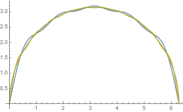

Thanks. Yes, for instance is it ##\psi(x)=Cx^{\frac{1}{2}}(L-x)^{\frac{1}{2}}## possible state in the well? I think that this function is ##L^2[0,L]##, but it is not ##C^{\infty}_0(\mathbb{R})## function. Right? Or to rephrase is it possible to write down
[tex]\psi(x)=\sum^{\infty}_{n=1}C_n\psi_n(x)[/tex]
where ##\psi_n(x)=\sqrt{\frac{2}{L}}\sin \frac{n\pi x}{L}##?

Indeed I just used the unnormalized function ##\psi(x)=\sqrt{x}(2\pi-x)##. Then ##\|\psi\|^2=4 \pi^3/3##, and a numerical evaluation of ##\sum_n |c_n|^2## gives the same. There is no problem with expanding this example wrt. the energy eigenfunctions ##\psi_n=1/\sqrt{\pi} \sin(n x/2)##.
Here is a plot comparing the wave function with the expansion using the first 10 and 20 (in fact only 5 an 10, because every other coefficient is 0)
