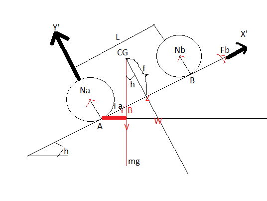

I´ll need an image to show the problem:
A bike with length L is on an inclined plane, the distance between the center of gravity and center wheel centers A,B is L/2.
Brakes are acting on the wheels so we have a static position.
In the picture is possible to see normal forces perpendicular to the plane Na,Nb, friction forces Fa,Fb and the gravity force acting at the CG point.
I have to calculate the value of the forces and moments on the system in order to get the equilibrium.
I´ll use the coordinate system X', Y' with origin A. And angle h, the lenghts L,f are known.
Sum Fx= 0
Sum Fy=0
Sum Ma=0
In order to calculate the moments I´ll need the moment arms. Since the reference point is A forces Na, Fa, Fb won´t be calculated since their moment arms are 0.
The gravity has a moment arm that I showed with a strong red line.
I´m going to calculate it:
Distance AZ= L/2 ; BZ=f/ tg (h) ; So the distance AB= L/2 - f/tg(h)
In the triangle AVB I see:
cos(h)=AV/AB----> AV=moment arm=cos(h)*AB
And the moment arm of the force Nb is simply L, finally:
Sum Ma= -mg*(cos(h)*(L/2- f/tg(h))) + Nb*L = 0
Sum Fx= Fa + Fb -mg sin(h)=0
Sum Fy= Na + Nb -mg cos(h)=0
And my problem is that I have three equations and four unkown quantities: Na, Nb, Fa, Fb.
Is this one of those cases of static indeterminacy?
Have I done any mistakes?
Maybe I should use a condition like Fa=Fb or Na=Nb but I can´t see any physical reason behind those conditions so I won´t use them. Experience tells me that Na will be higher than Nb on this inclined plane.
So I´m surprised, or I´m doing something wrong or it´s not possible to calculate this problem without any extra assumption, I´ll wait for your answers to check what´s happening here.
Thanks!

looks good
BZ=f/ tg (h) ;
error here...BZ = f*(tan h)

You are correct that Na and Nb cannot be equal here, from your sum of moments equation. There is yes indeterminancy in the friction force calculations for Fa and Fb, but the usual assumption is that they are equal, on the basis that the brakes are applied on each wheel similtaneously. I suppose that if you had brakes applied on one wheel only, say A, then Fb would be zero, or if you applied the brakes on A first, the bike stops, then you apply the brakes on B, Fb would still be zero, but there is no way to determine this, so assume Fa=Fb. Your work looks very good other than the trig error.

Ups yes I made that mistake. I have recalculated everything using these four equations:
1. fa=fb
2. Sum Ma= -mg*(cos(h)*(L/2- f*tg(h))) + Nb*L = 0
3. Sum Fx= Fa + Fb -mg sin(h)=0
4. Sum Fy= Na + Nb -mg cos(h)=0
From the third equation is easy to obtaing fa and fb:
fa=fb=mg sin(h)/2
Using the fourth equation I get:
Nb= mgcos(h) - Na
And I use that on the second equation so:
-mg*cos(h)*(L/2- f*tg(h))) + (mgcos(h) - Na )*L = 0
Na= mg cos(h) (1- (L/2 -f * tng(h))/L )
Using this value now I can calculate Nb:
Nb=-mg cos(h)/L * (L/2 -f*tg(h))
Using f=1 meter ; Mass= 115 kg; h=45º ; L=1meter I get these results:
Na=1195,5 N (121 kg)
Nb= 398,5 N (40 kg)
These results look like quite surprising to me because only at 45º you have three times more weight at the rear than at the front.

This is an assumption, without more info, but it doesn't affect your results for the normal force calcs.

the algebra gets a bit messy the way you have done it, your signs might be messed, but anyway, for the values you have chosen, the bike will tip over, because the cg acts to the left of A (Na points up and Nb points down, but because the normal force at B cannot act downward unless the wheel at B was anchored to the ground, the wheel B will lift and the bike will tip about A.

I haven't tried to wade through your working, but there must be a mistake somewhere.
Na+Nb = mg sin(θ)
Moments about the point of contact of lower wheel:
Nb L = mg((L/2) cos(θ) - h sin(θ))
Nb = mg(cos(θ)/2 - (h/L) sin(θ))
whence
Na = mg(sin(θ) - cos(θ)/2 + (h/L) sin(θ))
Fa+Fb = mg cos(θ)
The above is all independent of assumptions re relative strengths of Fa, Fb. Applying Fa/Na = (Fa+Fb)/(Na+Nb) gives
Fa = Na cot(θ) = mg(1 - cot(θ)/2 + (h/L) )cos(θ)
When Nb < 0, cos(θ)/2 < (h/L) sin(θ), tan(θ) > L/2h. At this point the mass centre is beyond the point of contact of the lower wheel and the bicycle will overbalance.
The cg will be a bit lower, but you happen to have chosen a very steep incline that will overturn the bike. You might want to choose a less steep incline like 20 degrees to avoid this. Also, you can solve directly for Nb from your 2nd equation and avoid the more tedious algebra.

Maybe I´m confused but, Why mg sin (θ) is on the y axis? I thought it was projected to the x axis, and that´s the reason I put that on the x-axis equation with Fa and Fb.
THat´s a good idea, I´m not interested in Fa, Fb so I´ll try to calculate this only with the equations for Na and Nb:
Na=mg cos(h) - Nb
Nb= mg( cos(h)/2 -f * tg(h)/L)
I get:
Na= 115*9.81*cos(20) - 119.44 = 940N
Nb= 115*9.81*(cos(20)/2 - 0.36)= 119.44 N
Definetly if the tangent at Nb is for a 45º angle the value of Nb is negative, but for 20º it´s positive, maybe it´s too high but experience tells me that I could survive to that angle on my bike without turning around like a boomerang, maybe my intuition is wrong and it wouldn´t be possible to get equilibrium at that angle.
For 20º the weight at A it´s 7,87 times bigger than it is at B, and this is a very conservative approach since the CG is at the midpoint between A and B which is false.
Maybe with more realistic data it´d be possible to show that it´s≈10 times bigger which is quite surprising to me, I didn´t expect such an enormous difference between the two wheels.
Whoops - sorry. Don't how that happened. Let me try that again:
Na+Nb = mg cos(θ)
whence
Na = mg(cos(θ)/2 + (h/L) sin(θ))
Fa+Fb = mg sin(θ)
Fa = Na tan(θ) = mg(1/2 + (h/L)tan(θ))sin(θ)
When Nb < 0, cos(θ)/2 < (h/L) sin(θ), tan(θ) > L/(2h). At this point the mass centre is beyond the point of contact of the lower wheel and the bicycle will overbalance.

Hi Haruspex
Yes maybe the distances choosen are not correct for this problem and we are getting an strange result for the Nb value. I´ll try to measure more realistic data.
There is one thing that I´d like to talk about with you, you used a relation between friction and normal forces that does not show an inverse relation between Na and Nb.
If you write that Na it´s proportional to Na + Nb that won´t show the fact that on a inclined hill the bigger the angle the bigger Na will be compared to Nb, I mean Why didn´t you prefer to use this relation Na*Fb=Nb*Fa ?
I think that this relation shows that the less weight you put on B, the more is going to A, Isn´t that true?
I see that you think that fa and Na increase at the same rate which is interesting, the truth is that I´d like to measure all this things to really know what´s happening.
I used the form Fa/Na = (Fa+Fb)/(Na+Nb) because it was more convenient, but it's the same thing. If you multiply it out you'll see that.
Ups now I understand what you mean, well thanks to everybody for the help :)
