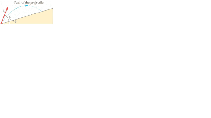

An object move in trajectory as shown. Find:
a. the time when the particle falls to the plane
b. tan⁡ θ[SUB]i[/SUB] so that the particle hits the plane vertically
Projectile motion
a. I tried to "rotate" the inclined plane so the surface of the inclined plane becomes horizontal
h = Vi sin θi . t - 1/2 g cos ∅ t2 and when it falls to the plane, y = 0 so:
0 = Vi sin θi . t - 1/2 g cos ∅ t2
t = (2 Vi sin θi) / (g cos ∅)
Is this correct?b. Particle hits the plane vertically means that vertical component of the velocity must be zero. Since the vertical component of velocity of the object will never be zero if we take horizontal line as reference so I think I need to take the surface of inclined plane as reference.
Vx = 0
Vi cos θi - g sin ∅ . t = 0
Then I don't know how to continue
Thanks
No, if it hits vertically then the horizontal component is zero. But that will only happen if it was vertical on take off, so makes no sense.
I would think question should specify either horizontally or normal to the plane.
Assuming the question means that the projectile hits the plane at a 90 degree angle to the plane: You already have an expression for ##t## for when the projectile hits. Insert this and solve for ##\tan\theta_i##.
Ah yes, my bad. I mean horizontal component of velocity is zero. I think horizontally is impossible so I assume the question is referring to normal to the plane.
Oh ok, don't realize I can use time from question (a)
Thank you very much for the help haruspex and orodruin
I am not sure you can just "rotate the plane" to solve for t. The projectile is launched at an angle ##(θ+∅)## to the horizontal. Unless angle θ is supposed to be between projectile vector and horizontal rather that between projectile vector and inclined plane as appears to be the case in your diagram ?
The OP has done that part correctly.
I "rotate the plane" so that the object moves with initial angle θi and I also "rotate" the acceleration of free fall so it has component in both horizontal and vertical direction
Ok - sorry. Missed that you were also 'rotating' g.
