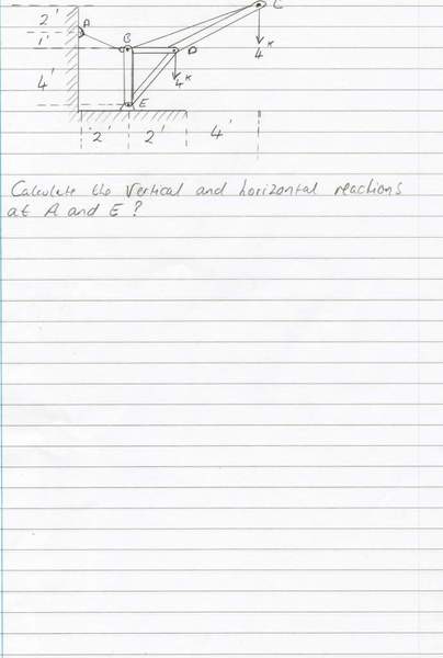

Hi, can anyone show the correct method of how to solve a problem like this. Got the answers from my book but have no idea how they get them?
Thanks
James
Thanks
James
What is the general method for solving statics problems like these? Since the mechanism is static, what can you say about the sum of the forces and moments on the various parts? Does that help you to start to draw some things and write some equations?
Yes I know how to apply the equilibrium equations and have the answer for the vertical and horizontal reactions and point A as, 8 kips and 2 kips. But when i try to apply this I can't get the answer. Confused
James
Sorry If you think this is a homework question, but is just a problem out of an old statics book i bought and wanted to check if I could still solve these questions. Evidently not
James
Could you please write out those equilibrium equations for us for points A-E? Show us what you have so far, and that should help us to help you.
