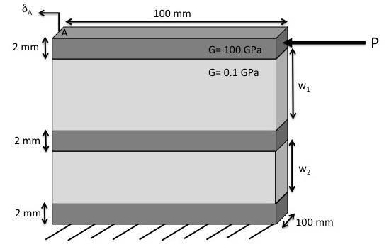

Find the displacement (mm) in the horizontal direction of point A due to the force, P. P=100kN w1=19mm w2=15mm
[itex]\tau[/itex] = G * [itex]\gamma[/itex]
[itex]\tau[/itex] = Shear stress = P / A
[itex]\gamma[/itex] = Shear strain = (pi / 2) - [itex]\alpha[/itex]
I haven't attempted to work out a solution here yet, but I do have a question regarding the separate G values that are given.
Can I just look at the top layer, the layer where P is acting, and use that G value to determine [itex]\delta[/itex]? Or do I need to do something with the other G value as well?
If I were to try something, I would find tau by doing 100[kN] / (100[mm] * 2[mm]). So tau would be equal to 1[kN]/2[mm2] = 0.5[GPa]. Next I would find gamma by dividing tau by G (100[GPa]) giving me [itex]\gamma[/itex] = .005rad. I can use trig to define gamme as [itex]\gamma[/itex]=sin-1([itex]\delta[/itex]/40). Setting this equal to .005 I would get [itex]\delta[/itex]= .20[mm].
Even if I do have to do something with both of the G values, I feel like my method is correct. Any help is appreciated, thanks in advance.
  • Diagram of a block with alternating horizontal layers: thin 2 mm layers labelled G = 100 GPa alternate with thicker layers labelled G = 0.1 GPa, heights w1 and w2. Force P applies horizontally at top right, displacement delta A at top left corner A, base fixed, width 100 mm.

If delta at A is relative to the fixed base, then all the shear displacements of the various layers must be taken into account.
Am I correct in assuming the shear force will be the same at all the various layers?
I'm getting closer to the correct answer. First I set V/A, where V is the internal shear force and A is the area of the cross section where the shear force is acting, equal to G*[itex]\gamma[/itex], where G is the modulus of rigidity and gamma is the shear strain.
I rewrote gamma as pi/2 - θ, where θ=cos-1([itex]\delta[/itex]/h), h is the height of the "layer", and put it all together so that my equation looks like this:
V/A = G * ( pi/2 - cos-1([itex]\delta[/itex]/h) )
Solving for [itex]\delta[/itex] I come up with
[itex]\delta[/itex] = h * cos( (pi/2) - V/AG)
I used this formula for each "layer" and added up all of the deltas.
However after plugging my numbers in and making sure of correct units, I still am off by fractions of a millimeter.
Also, should the h value be the height of the layer only or should it go from the base to the top of the layer I am looking at? For example if I am looking at the first layer where G=0.1MPa, would my h be simply w2 [mm] or would it be w2+2 [mm]?
I keep getting an answer that is off by fractions of a millimeter. I can not figure out what I am doing/not doing that keeps giving me a wrong answer.
How do you know that "an answer that is off by fractions of a millimeter" is "a wrong answer"?
