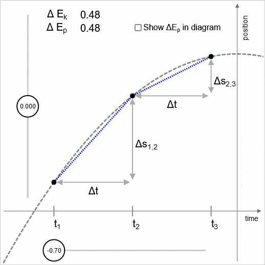

In differential calculus the unit of operation is a pair of points, the line through those two points is tangent to the curve you are looking to solve for.
In calculus of variations the unit of operation is a triplet of points.
Diagram 1 is an animated GIF that represents that unit of operation.
(The animated GIF is composited from screenshots of an interactive diagram.)
Diagram 1 - Unit of operation
In diagram 1 the intermittent line is a parabola. This parabola represents height as a function of time of an object that has been thrown upwards. A uniform force is acting in downward direction. To obtain the simplest possible parabola the value of the (uniform) acceleration is set at 2 ##m/s^2##
The outer points (##t_1## and ##t_3##) are treated as fixed; variation is executed by varying the position coordinate of the middle point.
In the diagram two adjacent time intervals are evaluated; ##t_{1,2}## and ##t_{2,3}##
The sweet spot is the point where the change of velocity is such that the difference in kinetic energy matches the difference in potential energy.
(In this diagram a uniform acceleration is used, which means that in this diagram the potential increases linear with height, hence ##\Delta E_p## is in this diagram constant. In the general case the force changes as a function of the position coordinate. Then the potential is not linear, and the value of ##\Delta E_p## changes as a function of the position coordinate.)

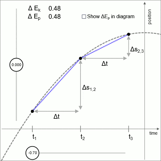

Diagram 2 - valid at any scale
Diagram 2 illustrates that the logic of this unit of operation is valid at any scale, down to the limit of infinitisimal time intervals.

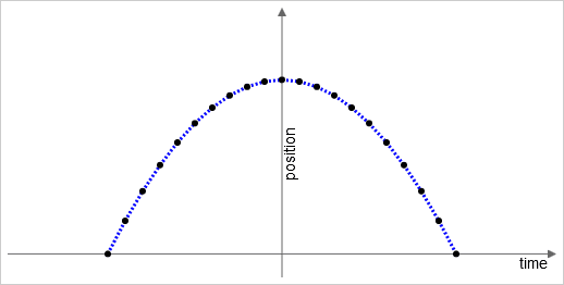

Diagram 3 - Concatenation
Diagram 3 illustrates concatenation of the unit of operation over the entire domain of the function you are looking to solve for.
The analogy with the unit of operation of differential calculus: you concatenate the unit of operation over the domain of the function you are looking to solve for, and then you take the limit of infinitisimally small intervals.
As an example of a source where this idea of concatenation of the unit of operation is discussed: the book 'Calculus of variations' by Gelfand and Fomin. Gelfand and Fomin demonstrate that the Euler-Lagrange equation can be derived using the functional derivative concept.
This representation as a concatenation is without loss of generality.

The logic that is demonstrated in diagram 4 is valid at any scale, down to infinitisimal.
When concatenating units of operation along the length of the overall time the bars end up exactly adjacent; no overlap.
This explains why the *integral* of the quantity (##E_k - E_p##) has the property that it is stationary when the variation hits the sweet spot. The value of (##E_k - E_p##) already has that property at the infinitisimal scale, and from there it propagates to the value of the integral of (##E_k - E_p##), as a function of variation sweep.

On both sides of ##t_2## the velocity changes; one side increases, the other side decreases.</p>
Before the change:
$$ v_{1,2} = \frac{\Delta s_{1,2}}{\Delta t} \qquad v_{2,3} = \frac{\Delta s_{2,3}}{\Delta t} \qquad (2.2) $$
After adding ##\delta s##:
$$ v_{1,2} = \frac{\Delta s_{1,2 } + \delta s}{\Delta t} \qquad v_{2,3} = \frac{\Delta s_{2,3} - \delta s}{\Delta t} \qquad (2.3) $$
The changes of the velocities:
$$ \Delta v_{1,2} = \frac{\delta s}{\Delta t} \qquad \Delta v_{2,3} = \frac{- \delta s}{\Delta t} \qquad (2.4) $$
The change of the kinetic energy component of Hamilton's action:
$$ \delta S_k = \frac{dE_{k(1,2)}}{dv_{1,2}}\Delta v_{1,2} + \frac{dE_{k(2,3)}}{dv_{2,3}}\Delta v_{2,3}
\qquad (2.5) $$
$$ \delta S_k = - \left(\frac{dE_{k(2,3)}}{dv_{2,3}} - \frac{dE_{k(1,2)}}{dv_{1,2}} \right) \frac{\delta s}{\Delta t} \qquad (2.6) $$
The total time is divided in equal length sub-intervals, so the move from interval (1,2) to the adjacent (2,3) can be rearranged to the form of taking a time derivative:
$$ \frac{dE_{k(2,3)}}{dv_{2,3}} - \frac{dE_{k(1,2)}}{dv_{1,2}} = \frac{d}{dt}\frac{dE_{k(1,2)}}{dv_{1,2}}\Delta t \qquad (2.7) $$
Combining (2.6) and (2.7) we obtain an expression for the change of the kinetic energy component of Hamilton's action as a function of &delta;<i>s</i>:
$$ \delta S_k = -\frac{d}{dt} \frac{dE_{k(1,2)}}{dv_{1,2}} \delta s \qquad (2.8) $$
Combining the two responses:
$$ \delta S = \delta S_p + \delta S_k = \left( -\frac{d E_p}{ds} - \frac{d}{dt} \frac{dE_{k(1,2)}}{dv_{1,2}} \right) \delta s \qquad (2.9) $$
