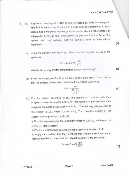

I'm stuck on part (b) and (c) of the following question
Scanned exam page, Page 8 of A19922, showing question 9 on statistical physics of N non-interacting particles in a magnetic field, parts (a) to (d) with equations for energy U and entropy S.

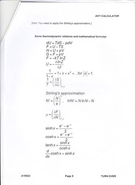

Page 9 of an exam paper headed ANY CALCULATOR, listing thermodynamic relations and formulae including dU = TdS - pdV, F = U - TS, Stirling's approximation N! ≈ (N/e)^N, and hyperbolic function definitions.
The partition function was ##Z_N = 2 cosh(μBβ)## where ##β = \frac {1}{kT}##. From there I used ##U = - \frac {∂}{∂β} ln (Z_n)## to get ##U = -NμB tanh( \frac {μB}{kT})##.
But I'm stuck on the part where it says "What is the energy U if the temperature approaches infinity?" Wouldn't the energy U be zero if the temperature approaches infinity? But then what does it mean in part (c) where it's assuming we have an EXPRESSION for U in the T→∞ limit? What is that expression? And how do I go about determining the entropy S of the system at infinite temperature?

Okay, I got tanh(x) ≈ x from the Taylor expansion, so I managed to obtain the expression ##U = - \frac {N (μB)^2}{kT}## for the T→∞ limit. Is this correct?
I'm still confused about the entropy part. Am I supposed to calculate the helmholtz energy first?

Hmm, I'm still not able to get the expression for entropy at infinite T as given in the question. Here's my attempt so far:
$$S = - \frac {∂A}{∂T} = - \frac {∂}{∂T} (-kT ln(Z_N)$$ where ##Z_N = (2 cosh(\frac {μB}{kT})^N##. When T→∞, cosh(x)→1 so ##Z_N = 2^N##. Therefore $$S = k ln(2^N)$$
But how do I get $$S = k ln \left(\frac {N!}{\frac {N}{2}! \frac{N}{2}!} \right)$$?

I got $$S = -Nk \frac {μB}{kT} tanh (\frac {μB}{kT}) + ln (2cosh(\frac{μB}{kT}))$$. Letting T→∞ gives ##S = -Nk (\frac{μB}{kT})^2 + ln 2##. Something doesn't seem right. I didn't even get to use the expression for U at T→∞ to get this entropy even though the question wants me to use it?
I just got it to work=let me show it to you momentarily...
Starting with ## A=-kT \ln({2^N}) ##, ##S=-\frac{\partial{A}}{\partial{T}}=k \ln{(2^N)} =Nk \ln{2} ##.
Meanwhile they give ##S=k \ln{(\frac{N!}{((N/2)!)^2})} ##. Using Stirlings: ##S=k[N \ln{N}-N-2(\frac{N}{2} \ln{(N/2)}-(N/2))]=k[N \ln{N}-N-(N \ln{N}-N \ln{2})+N]=Nk \ln{2} ##. ## \\ ## I don't know that their answer is exact. Using Stirling's on their answer gives you the exact answer. ## \\ ## In your previous post, you left off the exponent of ## N ## on the second term, along with a ## k ##. ## S=\beta U +k \ln{Z} ##.

$$S = k ln Ω(N,s) = k ln \frac {N!}{\left (\frac{N}{2} + s \right)! \left (\frac {N}{2} - s \right)!}$$
Applying Stirling's approximation gives:
$$S = k \left [NlnN - \left (\frac {N}{2} + s \right) ln \left (\frac {N}{2} + s \right) - \left (\frac {N}{2} - s \right) ln \left (\frac {N}{2} - s \right)\right]$$.
For part d)ii) it's asking for the Helmholtz free energy as a function of s. In the attached formula sheet Helmholtz free energyis given by ##F = U - TS##. So I'm guessing in this case U is given as ##U=-2sμB## in the question itself and we just obtained an expression for S, so $$F = -2sμB - Tk\left [NlnN - \left (\frac {N}{2} + s \right) ln \left (\frac {N}{2} + s \right) - \left (\frac {N}{2} - s \right) ln \left (\frac {N}{2} - s \right)\right]$$? If this is correct so far, in part d)iii) it asks us to the apply the condition that Helmholtz free energy is minimum under thermal equilibrium and show that the magnetic energy of the system is given by $$U=-NμB tanh(\frac {μB}{kT})$$, which is the same as the expression I got in part (a) from the partition function. I'm not sure how to apply this minimum condition to get the expression.
