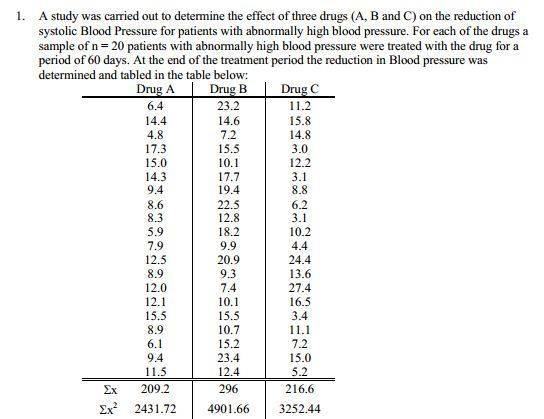

I have no idea where the sum of x^2 comes from, from the information I posted. I know it must be something pretty simple but its completely going over my head. In the picture that I've attached, I am wondering where the 2431.72, 4901.66, and 3252.44 come from. Thank you for any help.

What did you try to get Sum(x)? Sum(x^2)?
I tried squaring x, but obviously that is not correct.
Did you try, you know, adding up the columns of figures? That's what Sum(x) means. The other one is trickier: you've got to square each number, and then add them up.
