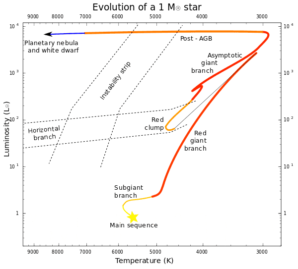

I don't think you are plotting what you think you are plotting, This is L vs. T:
Hertzsprung-Russell style diagram titled Evolution of a 1 M sun star, plotting luminosity in solar units on a log scale against temperature in kelvin, with temperature decreasing to the right, tracing the main sequence, subgiant branch, red giant branch, red clump, asymptotic giant branch and post-AGB path to a planetary nebula and white dwarf.
Do you see things on a line? I sure don't. I see a complicated curve. Further, such stars spend most of their lives at the bottom of this curve.
The post-AGB phase is short-lived, and the mass changes after the supernova explosion. Therefore, doesn't the scatter plot mainly consist of the process from main sequence stars to supergiants, and can appear in a form close to a straight line?
