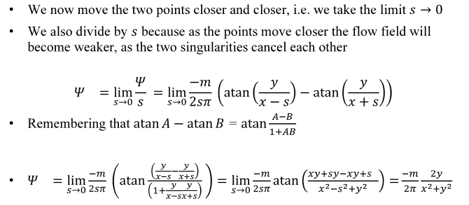

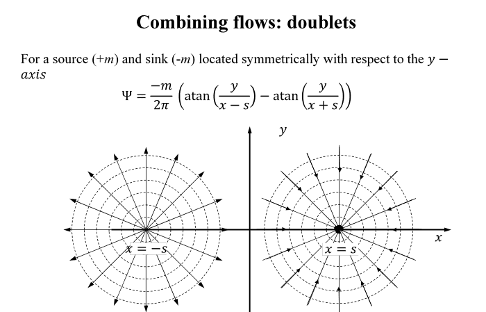

Hi,
I just wanted to ask a question about the derivation of the stream function [itex]\psi[/itex] for a doublet. In the pictures below is a derivation (in this one the source is on the left and the sink is on the right). I understand everything in the left photo, however my questions are:
1) Why do we divide by the distance between two sources [itex]s[/itex] before taking the limit? I cannot really understand the reason provided. I understand that the sources will cancel out, but am unclear as to why that means that we need to counter that by including a [itex]\frac{1}{s}[/itex] term.
2) Why does the derivation come out differently if we swap the placements of the source and sink? Intuitively, I feel that I have made an algebraic error, but I fail to see it. If we place the source on the right and the sink on the left, then we will get:
[tex]\psi = \frac{m}{2 \pi} \theta_{source} - \frac{m}{2 \pi} \theta_{sink} = \frac{m}{2 \pi} \left( atan(\frac{y}{x-s}) - atan(\frac{y}{x+s}) \right)[/tex]. Now we will get the same expression as before (except we have +m instead of -m), except we will end up with a different sign at the end. Surely, the end result should be the same irrespective of the original geometry.
I would appreciate any help. Thanks in advance.
Diagram of a doublet formed by a source at x = -s and a sink at x = s, with radial flow arrows and dashed circles, plus the stream function Psi = (-m/2pi)(atan(y/(x-s)) - atan(y/(x+s))).
Slide with bullet points deriving a doublet stream function: limit as s approaches 0 of psi divided by s, equals limit of -m/(2 s pi) times the difference of arctangents of y/(x-s) and y/(x+s), then the arctan subtraction identity and the simplified result -m/(2 pi) times 2y/(x^2+y^2).
If you swap the locations, the fluid velocities (calculated from the derivatives of the stream function) are, as expected physically, in the opposite direction. So what's the problem?
