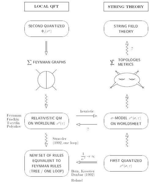

The key to understanding how perturbative string theory relates to QFT is to adopt the "worldline formalism"-perspective on QFT, see here, and see string theory FAQ – What is the relationship between quantum field theory and string theory?
Traditionally the perturbation series/scattering amplitudes of a quantum field theory are defined, given an action functional/local Lagrangian, by applying the Feynman rules to the monomial terms in the Lagrangian and deriving from that (via “second quantization”) a rule for how to weight each Feynman diagram by a probability amplitude.
In what is called the worldline formalism of quantum field theory this assignment is obtained instead more conceptually as the correlators/n-point functions of a 1-dimensional QFT that lives on the graphs, namely the worldline theory (usually a sigma-model in the given target spacetime) of the particles that are the quanta of the fields in the field theory.
Mathematically the key step here is a Mellin transform – introducing a “Schwinger parameter” – which turns the partition function of a worldline theory, schematically of the form ##t \mapsto Tr\, \exp(-t H)## (for ##H## the Hamiltonian/wave operator) into the zeta regulated Feynman propagator
\hat \zeta_H(s) = \int_0^\infty Tr_{reg} \exp(-t H) t^{s-1} d t = Tr_{reg} H^{-s}
This worldline formalism is equivalent to the traditional formulation. It has the conceptual advantage that it expresses the QFT (in perturbation theory) more manifestly as a second quantization of its particle content given explicitly of the superposition of all 1-particle processes.
The worldline formulation of QFT has an evident generalization to higher dimensional worldvolumes: in direct analogy one can consider summing the correlators/n-point functions over worldvolume theories of “higher dimensional particles” (“branes”) over all possible worldvolume geometries. Indeed, for 2-dimensional branes this is precisely the way in which perturbative string theory is defined: the string scattering amplitudes are given by the analogous “worldsheet formalism” known as the string perturbation series as the sum over all surfaces of the correlators/n-point functions of of a 2d SCFT of central charge 15.
https://dl.dropboxusercontent.com/u/12630719/WorlvolumeFormalism.JPG
Indeed, after decades of Feynman rules, the worldline formalism for QFT was found only via string theory in (Bern-Kosower 91), by looking at the point particle limit of string scattering amplitudes. Then (Strassler 92, Strassler 93) observed that generally the worldline formlism is obtained from the correlators of the 1d QFT of relativistic particles on their worldline.
(from (Schmidt-Schubert 94))
