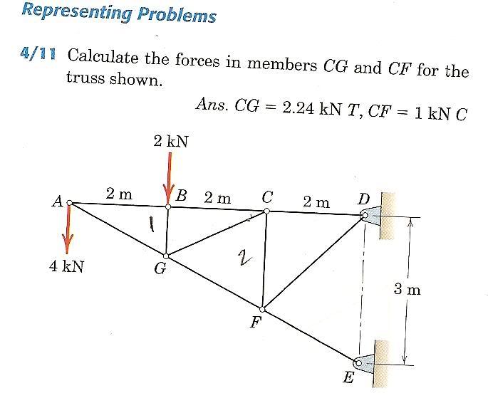

we are working on truss assemblys and i can't understand how this whole force moment thing works. the solutions that i calculate don't make sense when i try to visualize the situation.
here is one of my homework problems that i have been stuck on for a while now:
where do i begin the calculations?
when calculating the Fy forces should i include point E or just use one at a time (D & E)?
do i need to take the moment about some point? (i tried C and D, but both didnt seem right)
can someone PLEASE give me a clear and precise explanation on how to solve problems like this?
this is all i have so far and i doubt its correct:
Code:
SUM Fx=0...Dx=0
SUM Md=0...4kN(6m) + 2kN(4m) - A(6m)=0
                   A= 5.333kN
SUM Fy=0...5.333kN - 4kN - 2kN + D = 0
                   D= 0.667kN
but this just doesn't make sense for D...

You are quite right, you have made a good observation. The Fy reactions at D and E are statically indeterminate and you must examine the geometry of the members at those joints to determine them. The horizontal Fx componnets of the D and E reactions can be determined by summing moments about each support. Then it's plug and chug.

SUM Fx=0...Dx=0
A= 5.333kN
D= 0.667kN
OK...let's go over your equations. For the first one, we're summing forces in the x-direction, right? Don't forget the support reaction at E. That would give us: [tex]\Sigma F_{x}=D_{x}+E_{x}=0[/tex]. Thus, [tex]D_{x} = -E_{x}[/tex]
Next, it looks like you're summing the moments about D. That's the force perpendicular to a line intersecting D times the distance from point D. So, we should have [tex]\Sigma M_{D}=4kN(6m) + 2kN(4m) - E_{x}(3m)=0.[/tex] And [tex]E_{x} = 32/3[/tex]. Note that the force at A is given as 4kN, so you don't need to figure this out.
Finally, you're summing forces in the y-direction. Again, don't forget the support reaction at E. So, [tex]\Sigma F_{y}=-4kN - 2kN + D_{y} + E_{y}[/tex]. This really won't yield anything useful at this point, but you'll end up with [tex]D_{y} = 6 - E_{y}[/tex].
Hopefully, this makes sense. You now have the horizontal support reactions at D and E. Unfortunately, for this problem, those won't get you too far without some additional work. Turns out, you're better off ignoring the support reactions for now and solving the truss using the Method of Sections. Method of Joints will work, too...but you're looking at a little extra work. Try cutting the truss in a logical point and summing the forces at each edge point for the remaining section. You'll use the same methods we just used for the whole truss, except this time you'll be just analyzing a small section.
