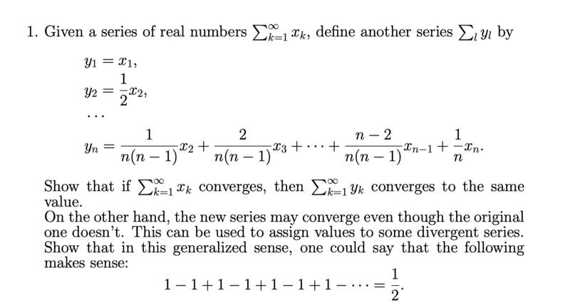

Using the given rule for the ##x_n##, write $$ \sum_l y_l = x_1 + \frac{1}{2} x_2 + \frac{1}{6} x_2 + \frac{1}{3} x_3 + \frac{1}{12} x_2 + \frac{1}{12} x_3 + \frac{1}{20} x_2 + \cdots + \frac{1}{n} x_n $$
$$ = x_1 + \sum_{n=2}^\infty \frac{1}{n(n-1)} x_2 + \sum_{n=3}^\infty \frac{2}{n(n-1)} x_3 + \sum_{n=4}^\infty \frac{3}{n(n-1)} x_4 + \cdots + \sum_{k=n}^\infty \frac{n-1}{k(k-1)} x_n $$
in general, ## \sum_{n=1}^m \frac{1}{n(n-1)} = \sum_l ( \frac{1}{n} - \frac{1}{n+1} ) = 1 - \frac{1}{2} + \frac{1}{2} - \frac{1}{3} + \frac{1}{3} + \cdots \frac{1}{m-1} - \frac{1}{m} - \frac{1}{m+1} ## The sum collapses like a telescope and everything is canceled out except for the first and last terms. Its limit as ## m \longrightarrow \infty ## is ##1##. So,
$$ = x_1 + x_2 + x_3 + \cdots + x_n = \sum_{k=1}^n x_k$$
The infinite series ## \sum_{n=1}^\infty x_n = 1 - 1 + 1 - 1 + \cdots ## diverges since its value alternates between 0 and 1. But, we write ## \sum_n x_n = \sum_l y_l ## and assume the new series converges to a number ##S##.
##\sum_l y_1 = S = 1 + 1 - 1 + 1 + \cdots##
subtract ##1## from both sides
##S - 1 = -1 + 1 + 1 - + \cdots##
##S -1 = - S##
##S = \frac{1}{2}##
i'm unsure about the part where ##S## is used as a variable for a mere algebra trick. it seems like the result from the first part of the question isn't really used.

I'm sorry. forgot to include the question.
In regards to the first part, you are almost there. You need to utilize the fact that Σxk converges. For the second part, while I have not done it, I assume that they want you to generate and find the limit of Σyk for xk=±1. Hint: look at the partial sums.
