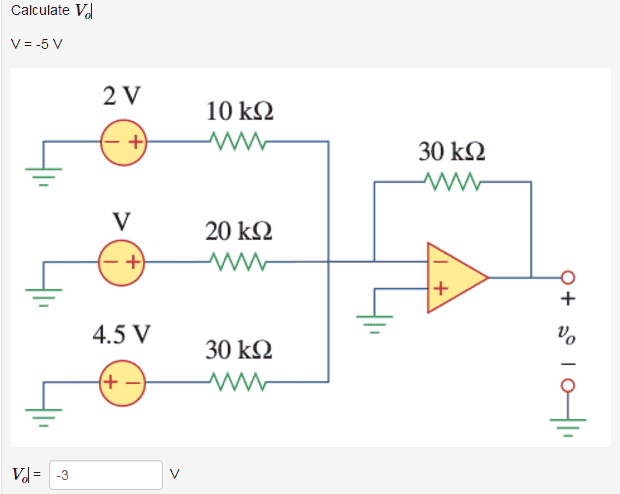

Solving for this circuit here, where V = -5V
I found the equation for a summing op amp like this one, plugged everything in and ended up with -3V, which is marked wrong. I'm really at my wit's end here and the homework has been incorrect in the past so I'm not even sure this is the wrong answer, any help would be appreciated.

Check the polarity on the 4.5.
Oh the sneaky bastards...
I got 6 volts for it thank you for your help!
