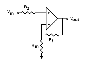

Consider the circuit drawn below
Op-amp circuit schematic: Vin feeds through resistor R2 to the non-inverting (+) input; the inverting (-) input connects to a node between Rin to ground and Rf, which feeds back from Vout.
This diagram was the closest I could find online to the one equivalent to my question, but there are some adjustments I need to clarify.
1)Replace Rz, Rf, and Rin, to R1.
2)Also, in my question, there's an extra wire connecting Vout to the right of Rz. In this wire, there is a resistor in the middle, called R2.
3) Switch the + symbol to the negative side and the - symbol to the + side.

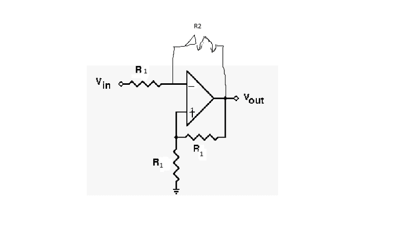

Edit: Here I redrew it in paint to give a better illustration of the circuit:
Hand-drawn op-amp circuit: Vin feeds the inverting input through R1, R2 is a feedback resistor from the output back to the inverting input, and the non-inverting input connects to a divider of R1 in series with ground resistor R1, with output Vout.
Now for the question:
A) In terms of Vin, Vout, R1, and R2, what is the voltage at the non-inverting input to the op-amp (v+)?
B) In terms of Vin, Vout, R1, and R2, what is the input current to the circuit ( the current through R1)?
c) In terms of Vin, R1, and R2, what is the output voltage (Vout) of the circuit.
Kirchoff's loop equations
V+ = V-
V= IR
I guess something I'm confused about in this question is if this is considered to be a non-inverting or inverting amplifer, since the wires go from both sides of Vout.
A)
So one of the main rules for op amps is that the voltage at the non inverting input will equal the voltage of the inverting input. This can be solved by using a voltage divider.
Therefore, at Voltage at the non inverting input, V+ = Vout(R1/(R1+R1)) = Vout/2
Also V+ = V- = Vin can be another way to express this. Therefore we also get the expression Vin = Vout/2
However, I'm not sure if this is correct, since the question wanted it in terms of 4 variables, while I only have it in terms of Vout.
B)
current = i = (V(-) - Vin)/R1 =[Vin-Vin]/R1
So the current cancels and becomes 0, which doesn't make sense. So something is wrong with part A.
I'm having trouble finding the voltage through the non inverting input for starters, so if anyone can help me through that it would be appreciated.

Ok so I redid that bit.
So we have V(-) = Vout/2
Using kirchhoffs law, the current through the R1 would be
Vin - IR1 - Vout/2 = 0
therefore, I = (Vin - 0.5Vout)/R1
and Vout would be
-Vout/2 - IR2 = Vout
Vout = IR2/1.5
=-R2(Vin-0.5Vout)/1.5R1
Would this be correct? I'm kind of confused when or not to use a positive or negative sign when making kirchhoffs equation for Vout/2

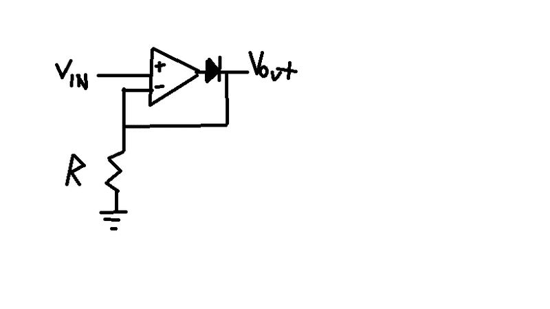

Is the input bias current difference through the current from the + and - inputs?
As for explaining ground, I think this example is kind of hard to understand since the R1s get in the way. For something like this,
Hand-drawn op-amp schematic: V_IN drives the non-inverting + input, the output feeds a diode to V_out, and the inverting - input is tied to a resistor R to ground.
The resistor is being grounded. Does that mean the voltage through the - input simply becomes the output voltage? And would the voltage across the resistor also be Voutput then? And the voltage through the diode be v input?
lets put some practical values in here ( I work easier that way )
Vin=1V, R1 = 1k, R2 = 10k
so I through R1 = 1V/1k = 1mA
V drop across R2 = I x R2 = 1mA x 10k = 10V
The R1, R2, -in node is going to be positive relative to the R2, op-amp output pin
so we know that the R1, R2, -in node is 0V, that means the output of the op-amp is going to be -10V ( relative to the input)
follow that ? :)

Unfortunately, I'm not really understanding. So if my answers for part A) and B) are right, I don't understand what is going wrong with part C).
Current through R1 = Vin/R1. Voltage drop across R2 = IR2. Therefore the voltage drop across R2 = Vin*R2/R1
I also thought, applying kirchhoffs rule, V(-) + IR2 = V(out).

yes, but more simply ...
thercias said:
Vout =2VinR2/R1 ?
no ... if you plug in the values I used as an example you will see it gives the wrong answer ( twice the value ... 20V instead of 10V)
now remember what I said a couple of posts ago ...
The R1, R2, -in node is going to be positive relative to the R2, op-amp output pin node
so gain ( because its an inverting amplifier) = -R2 / R1 = -10000 / 1000 = -10therefore ... + 1V in = -10V out, -1V in = +10V out

Okay got it I think. I was getting jumbled up with the original question when writing down my answers. Vout = -VinR2/R1 in that case I think.
Thanks for the explanations, and have a good night's sleep.
Like you pointed out, I would appreciate if someone would chime in and verify if these answers are correct, or how I can work through them if they are incorrect:
A) V- = Vout/2
B)IR1 = Vin - V-
I = (Vin - V-)/R1
C)V(-) + IR2 = Vout
0.5Vout + R2(Vin-0.5Vout)/R1 = Vout
0.5Vout = R2(Vin - 0.5Vout)/R1
0.5Vout(1+R2/R1) = Vin*R2/R1
Vout = 2Vin*R2/R1/(1+(R2/R1))
=2*R2*Vin/(R1+R2)
