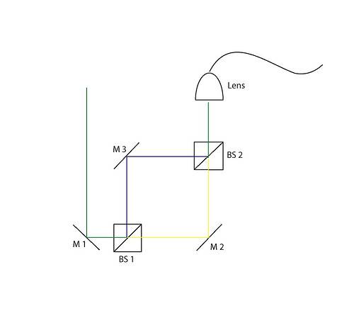

Yup, in fact the photon can be made to interfere with itself!
This is the quantum version of the Mach-Zehner inferometer.
