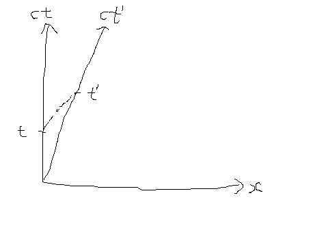

Hi guys, i have a very simple question here about K-calculus.
Suppose B is moving with speed v away from A.
At time = t, an explosion (event) occurs in A, sending light in all directions.
Spacetime diagram with axes ct vertical and x horizontal, showing a tilted axis ct' and a point labelled t on the ct axis and t' on the ct' axis, with a dashed line joining them.
According to the K-Calculus,
The time the explosion occurred in B would be:
t' = kt
But, using lorentz transformations:
t' = γ(t - vx/c2)
Since x = 0,
t' = γt
But it is quite clear that k≠γ..
Nevermind, I have solved it:
Time light from event received by B ≠ Time of event
Bu rather, the observer takes into account and B compensates for the time needed for light from the event to travel to him:
t' = kt - (v/c)t'
t' = kt/(1 + β) = γt (Shown)
Also on a side note, is it possible to prove the K-calculus using geometry? Which basically says that 'u' length along the ct axis would translate into 'k*u' length along the ct' axis..
