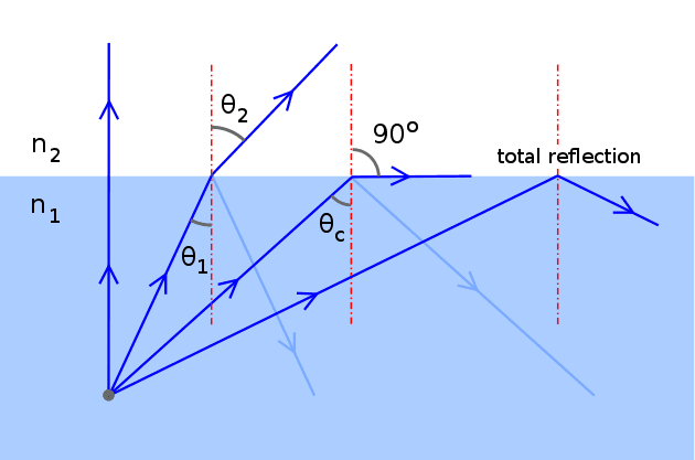

kuruman said:
Because of total internal reflection, the shark is visible to the drone at near-normal incidence but not to the surfers.
You do understand that total internal reflection does not result in a "dead zone" above the water's surface where the shark cannot be seen, right?
"total internal reflection" means that that some ray angles from the shark do not emerge from the water. That leaves plenty of other ray angles that do. Those plenty cover the entire above-the-water hemisphere.
To be fair, low angles do mean a severe loss of visibility.
I do understand that and I agree that there is no "dead zone" when one draws a ray diagram with the water surface perfectly flat which the ocean water is not. It seems reasonable to think that the severe loss of visibility that you mention is related to the ripples in the water surface. They scatter the light coming from the shark in many more directions when the viewing angle is close to the surface. The same ripples don't have much effect when the viewing angle is near-normal to the surface.
Jfmelero (adapted by Gavin R Putland) Wikipedia
Right. For sub-surface rays at angles between normal and ##\theta_c##, one has continuing above-surface rays covering the entire above-water hemisphere. No "dead zones".
jbriggs444 said:
No "dead zones".
That is true but the vertical angle subtended by the image of the shark will get narrower and narrower. (A submerged sphere image gets very oblate at low angle)) Coupled with a little surface chop and it no longer registers as a shark.
Yes, agreed.
