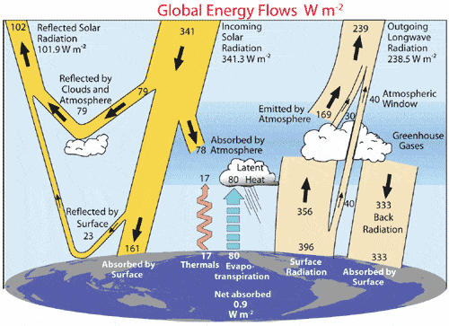

Sylas, that is just wrong. Take the following image for example:
Surface radiation accounts for the plurality of energy in our atmosphere and is directly related to subsurface thermal processes. If it wasn't for radiative decay of elements in the mantle and core (and perhaps i should have included the mantle in my previous statement) this would be a barren planet without any mountain building as we know it. This heat flux from the Earth's interior is actually the mechanism that broke down the "snowball earth" which lead to the explosion of life in the Cambrian.
Energy from inside the Earth does not figure in that diagram anywhere. All the surface radiation is accounted for by the energy coming in from the Sun. Just add up the numbers.
Surface radiation accounts for the plurality of energy in our atmosphere and is directly related to subsurface thermal processes. If it wasn't for radiative decay of elements in the mantle and core (and perhaps i should have included the mantle in my previous statement) this would be a barren planet without any mountain building as we know it. This heat flux from the Earth's interior is actually the mechanism that broke down the "snowball earth" which lead to the explosion of life in the Permian.
Perhaps I am missing something, but the incoming radiation is 341, 161 making its way into the earth, and the surface radiation is 356. That gives you a 195 W/m2 gap. When considering the thermal energy regularly released in volcanic activity, faulting, and other processes it would be hard to imagine that not playing a role in climate. There is an ongoing debate , however, among geomorphologists about climate forcing tectonics or tectonics forcing climate.
You are indeed missing something. In that diagram, you can add draw a horizontal line and add up fluxes inwards and outward at different levels. Don't forget the 333 flow energy down to the surface from the atmosphere as backradiation. Also, there's 17+80 flowing up as convection and latent heat.
The numbers don't quite balance due to some rounding errors, but there's no role whatever for heat from inside the Earth. It's too small to matter. In fact, that diagram indicates a slight excess of heat energy flowing DOWN, into the ocean. The reasons for this are beyond the scope of this thread; in the paper from which that diagram is taken, this is associated with increasing temperature of the ocean in the current climate, due to heat coming in from above.
