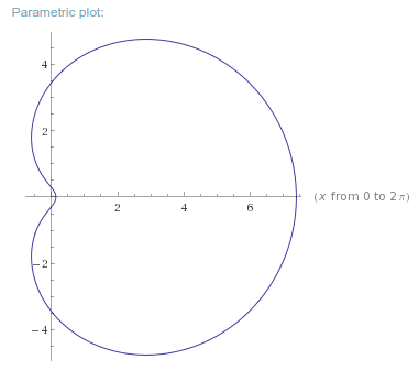

Solving a differential equation tends to exponentiate things. Consider the complex circle ##2 e^{i \theta}##. What happens when we exponentiate it? Make a parametric plot of ##e^{2 e^{i \theta}}## and you get this:
Screenshot from 2016-03-29 14:29:34.png
Which is not circularly symmetric like its input was.
That's not a full explanation, but I hope it gives an intuition for why the spherical symmetry could be lost.
(Actually, because the Hamiltonian is scaled by ##i##, exponentiating tends to introduce cycling. But the cycles are in the phases of amplitudes, not in physical space.)
