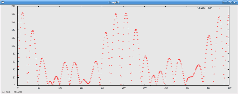

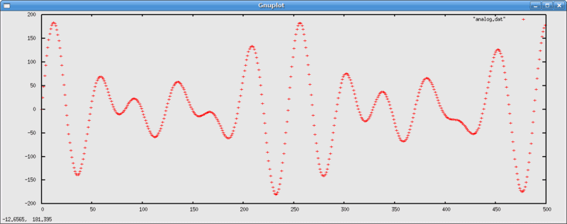

Here are shots of the analog and digitized wave for C-E-G.
Am I handling negative numbers correctly?

1) You are not handling negative numbers properly. You need to produce a signal in the range -128 to +127, convert it to an integer, and add 128 to it. That will produce a signal that ranges from 0 to 255. Obviously, your "analog" and "digital" waveforms should look the same, just with different numbers along the y-axis -- but they do not.
2) What you're currently creating is called PCM (pulse-code modulated) data. Your /dev/audio device by default expects mu-law encoding, not PCM. It won't ever sound right unless you reconfigure it to expect PCM data.
3) Consider using a better interface to /dev/audio than just throwing bytes at it. Try ossaudiodev, http://docs.python.org/lib/ossaudio-device-objects.html You should be able to set /dev/audio to accept PCM data first, and then it should be able to handle your sound data properly.
