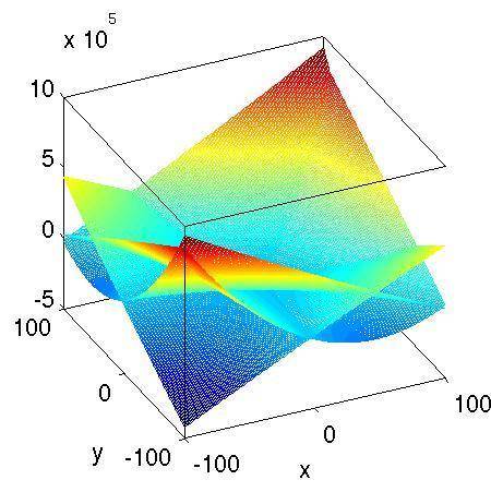

I'd suggest a graphical approach to the subject.
(see post #3 for reference). I'd put the resulting (A) and (B) equations in a canonical form of ellipse (possible circle) and do the drawing and see whether the 2 closed curves intersect. If so, i'd get approximate values for intersection points's coordinates => approximate sollutions to the initial system of equations.
Daniel.
Graphically :smile:

If you have f(x,y)=g(y,x), then your system of equations is f(x,y)=0 and f(y,x)=0. If there are solutions that are not of the form y=x, there are related solutions obtained by switching x and y. I see no guarantee that you will always get "nice" real solutions (that is, solutions that can be written with radicals) when you do have real solutions. Then again, I'm not familiar with the conditions for nice solutions to quintic and higher degree functions, so I may be missing something.
Thanks everybody,
Especially to Lee ,who confirmed by Maple that the only real solutions are x=y=1/3,z=-16/3.
