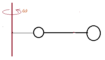

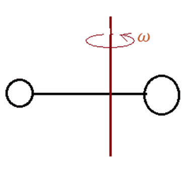

Consider a dumbbell rotating about the axis as shown. Both balls have the same angular velocity ##\omega## in the same direction. The linear velocities of the two balls will be in opposite directions with different magnitudes.
  • #42

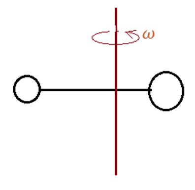

But what if the balls were rotating about an outside axis. Both will have same direction of linear velocity. However when the that system is analysed about an axis passing in-between the balls, the linear velocities being kn the same direction will make angular velocity in opposite directions.
  • #43
Suppose the dumbbell rotates about an "outside" axis. Both balls will have the same angular speed ##\omega##. Their linear velocities will be in the same direction (with different magnitudes). Also, their angular velocities will be in the same direction (counter-clockwise as seen from above).
For the inside axis, the balls have the same counter-clockwise angular velocity as seen from above. If one ball makes 5 revolutions per second, so does the other ball. The linear velocities are now opposite in direction and have different magnitudes.
  • #44
But doesn't that change the system completely?
Applying that to wheels,
The wheels will stop rotating about the z-axis as cone would have and rather rotate about each other. But that is not the motion described in the question?
Aren't we supposed to analyse the system's motion as it is but about a different axis?
