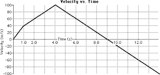

I agree. So look at this graph. I read this to say that the velocity is decreasing from 4.0 s to 14.0 s.
Quite frankly, I don't see any other way to interpret it unless you start incorporating speed into the discussion, but that isn't necessary because all of the information about the speed is contained in the velocity.
If this is 1-D motion, then you have plotted [say] the x-component of the velocity... and it's okay to just call it "velocity" (since it would be a 1-D vector).
And, yes, the [x-component of] velocity is decreasing from 4.0s to 14.0s.
(If the problem were a projectile problem in 2-D or 3-D, I would have a problem with the graph.)
Yes, I am just talking about 1-Dimensional motion.
I think this perfectly illustrates why most people are so confused by physics. We can't even agree on the way to put it into words among ourselves. Why make it more complicated than it needs to be? There is a change in velocity toward the negative direction. From 4s to 9s the change in velocity is in the opposite direction as the current velocity, so it is slowing down. From 9s to 14s (and maybe beyond) the change in velocity is in the same direction as the current velocity and the object is speeding up. When talking about 1D motion, sign only denotes direction, it is completely arbitrary which is which. It'd be like saying north is greater than south and moving from north to south is decreasing.
So to the original question, I would say the velocity is increasing magnitude in the negative direction.
