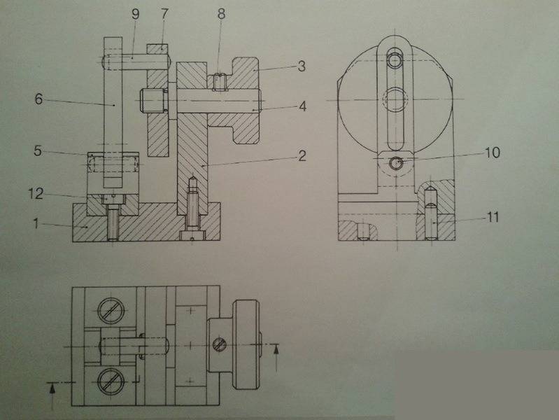

Hey, I have to do my homework in Technical Drawing where we have to describe the function and the assembly of any part. I have got a crank mechanism and I just want to know if I name all the parts correctly. I am not quite sure if everything is correct.
Here my parts list:
1: base plate
2: support
3: flange
4: crankshaft
5: piston
6: connecting rod
7: flywheel
8: grub screw
9: crankpin
10: pin
11: pin
12: screw
These are my suggestions, but maybe they're wrong or imprecise. I hope you can help me if anything is wrong. Thanks a lot.

Naming parts isn't a precise science but..
I'm not convinced that "piston" is the best description for 5. However I'm not sure what to suggest as an alternative. Perhaps something like "rocker pin mounting block"
I'm not convinced that this mechanism is intended for continuous high speed rotation so is 7 really a flywheel? Perhaps "Crank Wheel" is better?
I was taught that a screw was fully threaded where as a bolt may only be partly threaded. That would appear to make 12 a bolt rather than a screw. However many other sources say that it's only a bolt if it has a nut. Perhaps stick with screw.
Perhaps wait for other suggestions.
