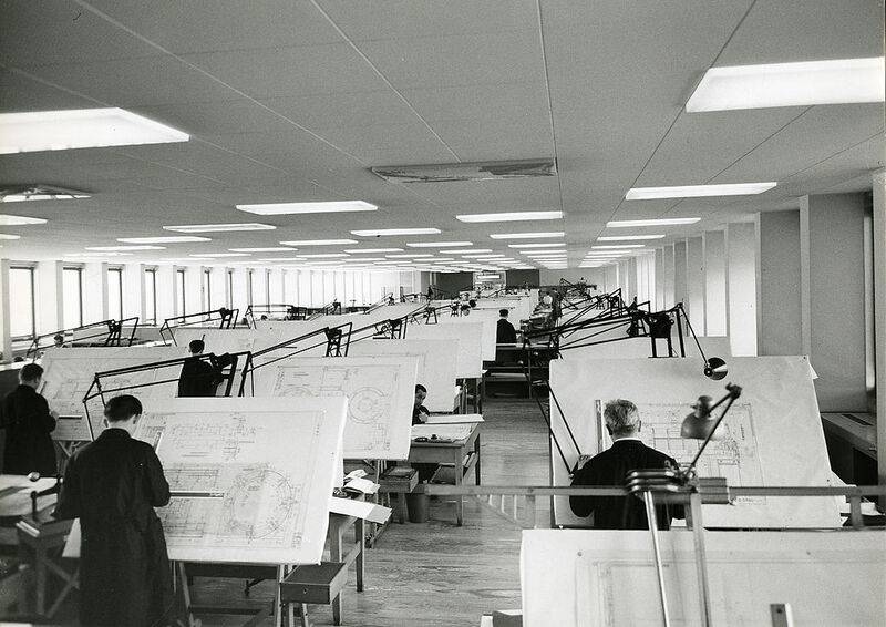

The paper was very erosive on the graphite, which made the process slow via endless sharpening of wood pencils.
Using drafting tables with protractor head, ink could be used directly on paper in a quicker and more productive way.
Tilting the table made easier the perpendicular positioning of the pens to the paper.
Please, see:
https://en.wikipedia.org/wiki/Drafting_machine

This engineers on your picture use rapidograph directly on paper, if yes, when they make mistake how they erase ink?

Sharp knife and alcohol.
Even when using pencil as a guide, errors and ink spills were regular occurrences that required corrections.

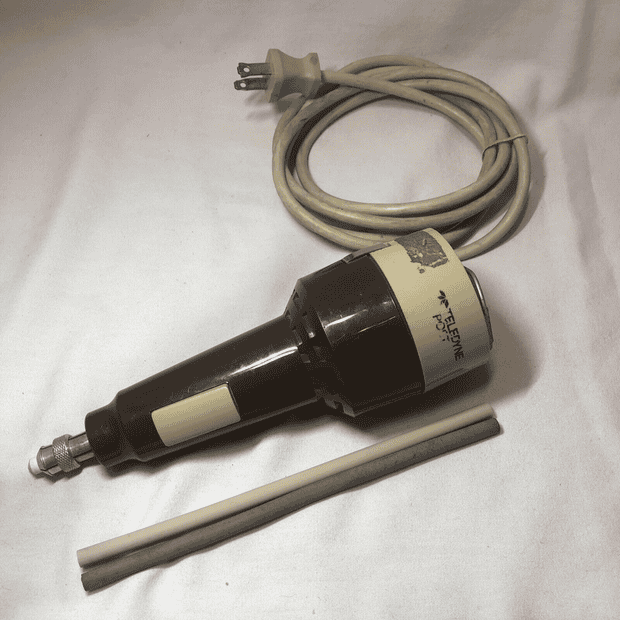

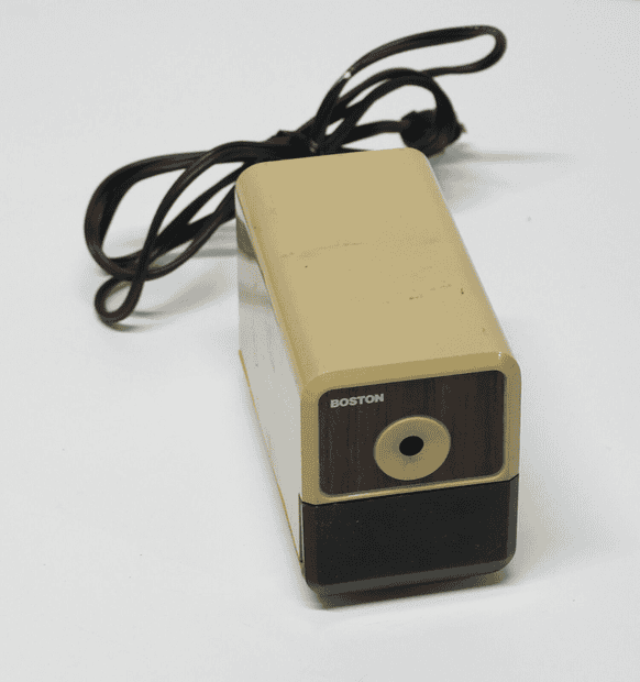

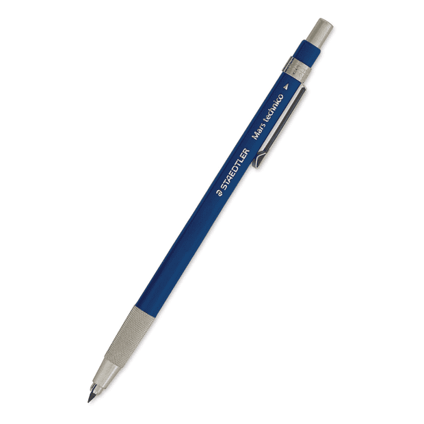

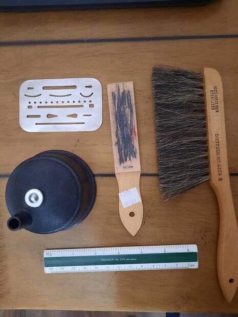

Things you could have found at our drafting tables back in the day:
