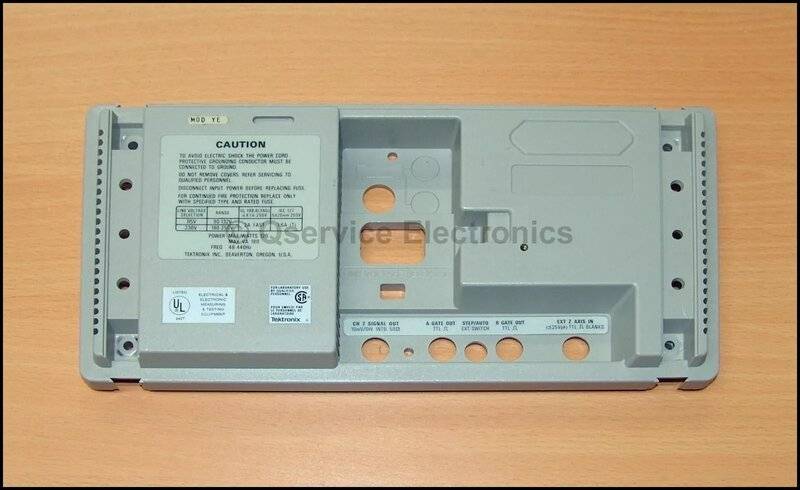

I have a Tektronix 2465A oscilloscope. There is on the rear panel a ch.2 output. How can I change that to a vertical output as was the case for the older 500 series scopes. The mode control determined what output was present.
Chan 2 is a vertical channel and is an output.
Maybe use Chan 2 for the signal rather than Chan 1.
As @Baluncore points out, that is already the Ch2 Vertical output. Do you want some other channel output instead of Ch2?

I want the same functional output as the old 1A1 provided with a 500 series scope. I want to switch the output signal; ch.1 , ch.2, ch.1-ch.2. I can do that with a 7000 series scope but I would like to modify my 2465A.
Download the 2465a-and-2467-service-manual linked in post #2.
Go to the block diagram on page 10-4
Locate CH 2 OUT and follow it back to the CH 2 preamp.
Notice how Module 6 is the vertical channel switch.
You will need to somehow take the output from after that channel selection switch to the CH 2 OUT.
Page 10-23b shows the output from the selection switch is a differential voltage, from the switch through the vertical amplifier, U600, to the beam deflection.
You will need to find a difference amplifier, to convert the differential signal to a single-sided signal, that can go to the repurposed CH 2 output.

Thank you for the detailed response. That looks to be more work than I am ready to attempt. I did find for <$300 a 7000 series rack mount scope that does the job. I am using the vertical signal output to measure feedback loop gains in the fashion of HP/Middlebrook.
