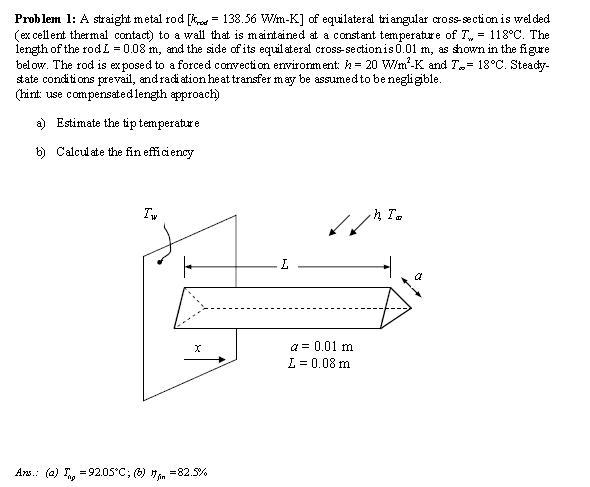

Temperature at the tip of a fin
  • Thread starter theBEAST
    Temperature
theBEAST
361
Diagram of a straight triangular-section metal fin attached to a wall at temperature Tw, with length L = 0.08 m, side a = 0.01 m, and convection h, Tinf on the free end.
I initially found the temperature tip without accounting for the corrected length. But the solution uses the corrected length for finding the temperature which doesn't make sense to me. Don't we want the temperature at the tip L, if we find the temperature at the corrected length then that isn't the ACTUAL temperature, it is an approximation we use to find efficiency I thought?
Both answers are pretty close, only off by around 0.01 C.

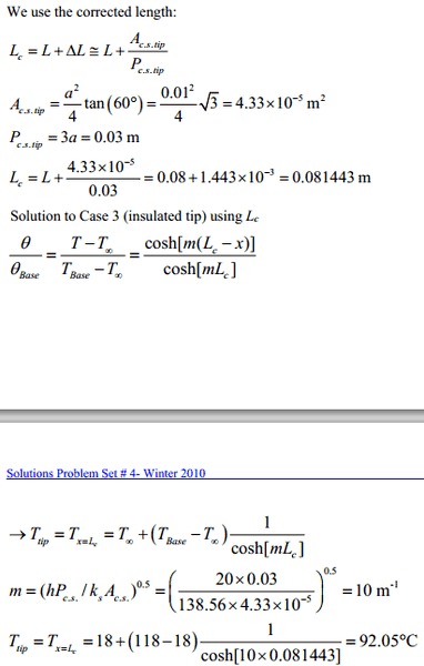

Here is the textbook solution:
Handwritten-style worked solution with equations for corrected fin length, cross-sectional area, perimeter, and fin tip temperature using hyperbolic cosine, with computed values 0.081443 m and 92.05°C.
