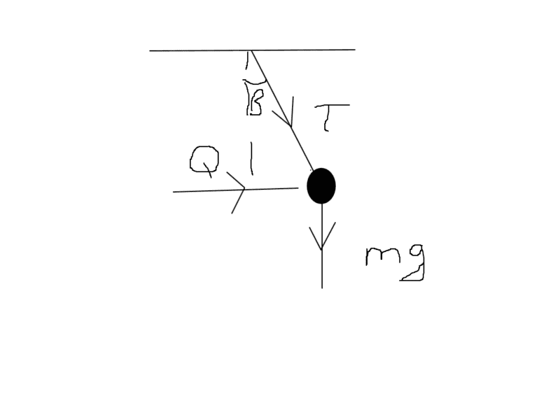

A ball of mass 0.5 kg is attached to one end of a cord of unstretched length 0.6 whose other end is fixed . When a horizontal force of QN is applied to the ball in equilibrium , the cord increases by 10 percent and is inclined at β= arcsin3/5 to the downward vertical. Calculate the value of Q and the modulus of the cord
T= λx/l where λ= modulus, x=extension and l=natural length
I have tried to solve it by using the above eqn and using a right-angled triangle. I think my visualization of the problem is somewhat correct. But I don't think my approach is.
Draw the free body (force) diagram. Write down all the equations you can based on all given information and the fact that the ball is not moving. Solve for T before you try to find the modulus.

Draw as many diagrams that you have time for that you think might be helpful. For now, I would suggest focusing on the free body diagram of the forces acting on the ball. Q, being a horizontal force applied to the ball, will only have a horizontal component. What are the other forces acting on the ball?
Yes, I have drawn my free body diagram. There is only the mg force that attracts the ball downward except Q. Since we have to find Q, I don't think we have to resolve it. There are
mainly two forces on the ball. One is this Q and the other is mg. But what about the angle?
I think the angle is created between the ball's original and current positions.
There is a third force, T from the cord. Since the ball is not accelerating, there is no net force on the ball. Force vectors T, Q, and mg add up to zero. If you can, please post your FBD.

Okay, since the ball is not accelerating, can I set the eqn, T=mg and using this information can I find out Q using the expression, Q=Ttanβ??
T is not equal to mg. Please post any drawing you have. I want to make sure you understand the fundamental configuration of the system.

I have sent the FBD diagram in this attachment file. Check out the digram and see if there is any mistake

Oops I am sorry that I made a trivial mistake as I was in a bit of hurry to post it. So, now isn't there going to be a resultant force of Q and T like R=Q+T. Then isn't the equation going to look something like R-mg=ma
That's the idea. Basically you sum the forces Q, T, and mg to get ma, where ma is zero because the ball is not accelerating. To save some time, your next step is to break these forces into their x- and y-axis components. Once that is done, you can get 2 equations: the sum of the x-axis forces = 0, and the sum of the y-axis components = 0.
Okay, I have got two simulatneous equations like Tcosα + Qcosα=0 and Tsinα + Qsinα=mg

You have 2 equations and 2 variables - take into account that cosa = sin(90-a)
You are given the angle: β=arcsin(3/5). You should be able to evaluate this with a calculator. This is also a geometric way to express an angle based on a right triangle. Take the sin of both sides: sin(β) = 3/5 = opp/hyp. You should be able to figure out what the "adj" side is.
T is the only force that has x AND y components. Q has only an x component, mg only a y component (x-axis is along the horizontal, y-axis, vertical).

Thank you lewando so much for your help. I finally understood clearly how I can solve these problems. I really appreciate the time that you have invested in posting these little hints that really clarified my concept of this problem and finally helped me to reach an answer.
My own explanation of the problem in brief. The x-component of T neutralizes the x component of Q. The y-component of T neutralizes the y-component of mg which is why the ball gains an equilibrium state thereby resulting in zero acceleration of the system.
