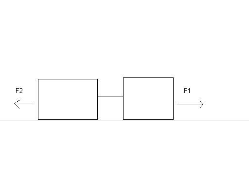

Two blocks A and B are connected by an ideal rope R, both blocks lie on a horizontal surface S. The coefficient of static friction (\mu_s = 0.30) and kinetic friction (\mu_k = 0.20) between the blocks and the surface S are the same for both blocks. The mass of block A is m_A = 6.12 kg. The mass of block B is m_B = 7.51 kg. A horizontal force F_1 = 50.39 N pushes the block A, a horizontal force F_2 = 26.81 N pushes the block B.
Assume g = 9.8 m/s^2.
(See picture)
What is the acceleration of the block and the tension on the rope?

But why this negative acceleration? Clearly my answer is wrong, since I assumed the positive direction the direction of F_1, which is greater than F_2. Please, help me.
I can't see your picture as yet.
Your equations indicate that the forces are in opposite directions?
If that is the case, then the total static friction that needs to be overcome is (6.12 + 7.51)*9.8*.3 = 40N.
But the net of the 2 forces is 50.39 - 26.81?
Is that the right idea of the problem?

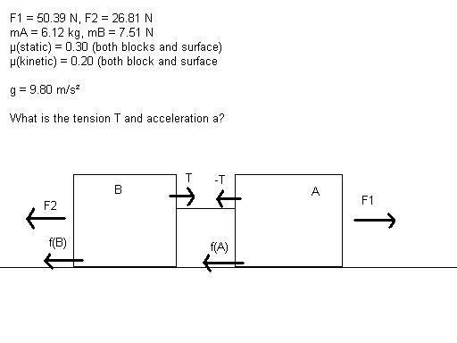

Obs.: I added up a new image with all the forces (except normal force and weight).
I would look at it this way.
If it is a static system, then the system would be equivalent to a system that has no force on the smaller side and only the net in the larger side, wouldn't it?
In this case, rather than having 50.39N you would have just 23.6N acting to the left and 0 to the right.
That would mean then that Block B only could supply resistance of friction to the tension, if needed.
Now consider the forces on A. There is the net of 23.6 acting and up to 18N of static friction resistance that would be used up, necessarily first, I would think, until Tension was required to keep it static. Now since friction from Block B is not really an active force in the sense that it would do anything but resist tension up to its limit, then the only tension it would supply would be the tension necessary to keep A static.
In this case that would be 5.6N.
Add that to the original force from the lesser of the forces in the problem, 5.6 + 26.8 problem, yields the 32.4N that is the surplus needed over the 50.4N - 18N = 32.4N.
But by doing so wouldn't we be raising the friction on block B, since in the new system just the tension (which needs to be the same on the two equivalent systems) acts on the block B?
After finding the tension on the new equivalent system, if we move back to the old one and keep the tension the same, then the friction on block B wouldn't change?
I wonder if the system mentioned above is in some way just tension-equivalent?
Thanks for the reply.
If by tension equivalent ... you mean the tension is a pass through of the force from the lesser side. Because I see it as that plus whatever tension is needed to maintain the greater side in equilibrium.
Remember the side with the lesser acting force has no benefit from friction resisting it, because that force must act in the same direction as the lesser force to maintain the static system in the face of the superior force from the other direction.
