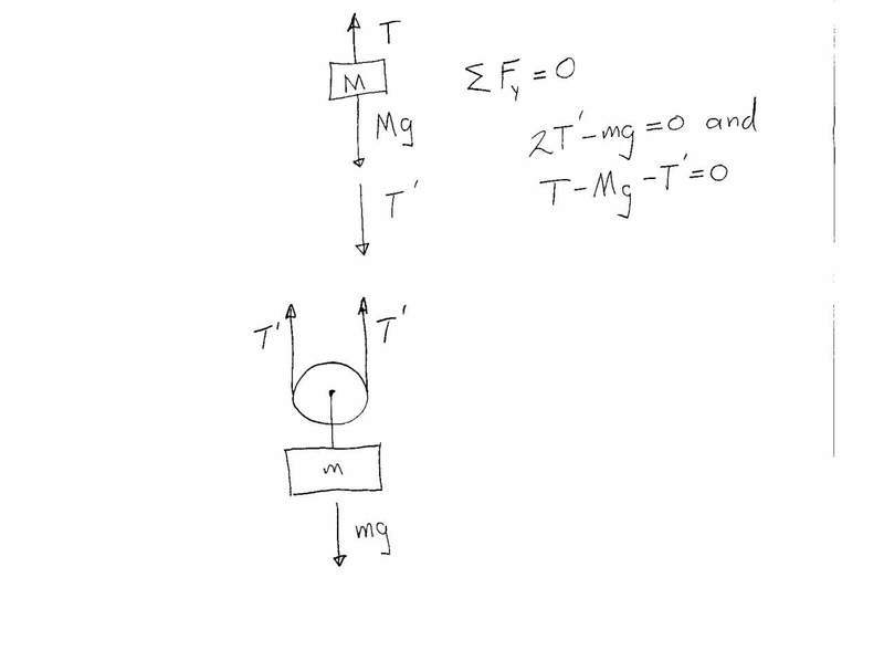

The discussion focuses on calculating the tension T in a massless, frictionless pulley system with two weights: m1 at 661 g and w2 at 5 N. The correct approach involves using free-body diagrams to analyze the forces acting on each mass. The user initially miscalculated tension by incorrectly assuming T equals the sum of weights. It is established that the tension in each segment of the rope may differ, necessitating a detailed examination of the system's dynamics.
