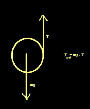

A string is wound around a uniform disk of radius ##10cm## and mass ##300g##. The
disk is released from rest when the string is vertical and its top end is tied to a
fixed bar. Determine the tension in the string. [ ##g = 10 ms^{-2} ##]
I think it is just ##300g \cdot 10 ms^{-2}## ;
If so, what is the net vertical force on the disk? What acceleration would result?
The accelaration of the disc is ##g## .
But, the disc will rotate, I think. And there should be a torque. I shown in the picture, the tension of the string ## T## will create the torque.

I shown in the picture, there is tension in the string, but the net force in the vertical direction is still ##mg## .

I suggest you follow the standard procedure and draw a correct free body diagram of the disk instead of the diagram you drew. Are you familiar with the concept of a free body diagram?
Yes.
I think it will be as I drawn below:
And, ##F_{net} = ma## ; where, ##a## is the accelaration of the disc.
Will it be, ##a = g## ?
And I think there will be a torque acting on the disc, which is equal to ##Tr## ; where ##r## is the radius of the disc.
Again, torque = ##I \alpha## ; where, ##I## is moment of inertia and ##\alpha## is the angular accelaration;
So, ##Tr = \frac{1}{2} mr^2 \alpha##; because, moment of inertia of a disc with radius ##r##, is ##\frac {1}{2}mr^2##
##\alpha = \frac {2T}{mr}##
Again, ##a = r \alpha##
##a = r \frac {2T}{mr}##
##a = \frac {2T}{m} ##
And so,
##mg - T = ma = m \frac{2T}{m}##
##mg -T = 2T##
##T = \frac{1}{3} mg##

That looks correct.:)
