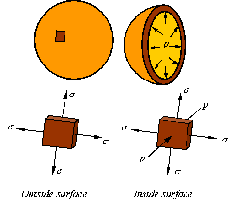

Point is hooks stress is no different from normal stress right?...I mean if hook's stress comes as 500 mega pascals, then the stress in the material is 500 mega pascals right?
The hoop stress is very easy to derive for this type of setup. There is no need for any fancy elasticity theory.
dE_logics said:
Point is, hooks [sic] stress is no different from normal stress, right? ... I mean, if hook's [sic] stress comes as 500 megapascals, then the stress in the material is 500 megapascals, right?
dE_logics: That is correct. Hoop stress is normal stress. Very good.
Sounds sarcastic.
Is there a conversion or something?
No. He was being serious. The hoop stress is the same thing as the normal stress because of the direction on an element that is perpendicular to a line around the circumference at some radius.
