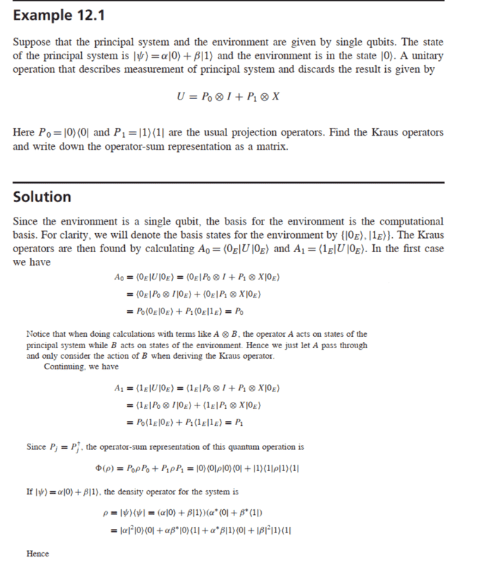

Hello, is there an operational order between tensor and matrix multiplications?
Hello, I am calculating the krauss operators to find the new density matrix after the interaction between environment and the qubit.
My question is: Is there an operational order between matrix multiplication and tensor product? Because apparently author is first applying I on |0> and X on |0> and obtain
I|0> =|0>, and X|0>=|1>. instead of first calculating U.
Then instead of making the tensor product he is distributing <0| .
Can someone please explain me why that's the case?
On attachment you can find more detailed explanation.
Thanks in advance!

Please give a reference to the book or paper at which you are looking, as I am not sure about the notation used, and I need more context. For example, what does ##\left| 0_E \right>## mean? Something about a qbit zero and the environment ##E##?

You can't simply apply the ##I##-part of the operator product to ##|0_E \rangle##. This would lead to the invalid expression ##\langle 0_E|P_0 \otimes |0_E\rangle##.
Instead, he does
\langle 0_E|P_0 \otimes I |0_E\rangle + \langle 0_E|P_1 \otimes X|0_E\rangle \\<br /> P_0 \langle 0_E| I |0_E\rangle + P_1 \langle 0_E| X|0_E\rangle
which is the proper way to do things if ##|0_E \rangle## and ##I## refer to the environement and ##P_0## and ##P_1## refer to the system (as George said, you should provide a tangible reference for context).

Hello, I hope the picture on the attachment helps!
It is from a book named "Quantum Computer Explained" by David McMahon.
Chapter 12, Quantum Noise and Error Correction

Thanks for the answer. How can you take out P0 and P1?
Are you familiar with the partial trace?
Kind of yes. I know how to calculate it but don't understand the concept behind.
Ok. Both the partial trace and your example involve expressions like
\langle \psi_E | A_S \otimes B_E | \psi_E \rangle
(where ##S## stands for system and ##E## stands for environment).
On a first glance, this looks like an ordinary expectation value which can be evaluated by applying the operator / matrix to the vector followed by evaluating the inner product. On a second glance, this doesn't work because the dimensions don't match: the vector lives in the Hilbert space of the environment which has a smaller dimension than the composite space (at least for finite-dimensional Hilbert spaces) on which the operator acts. So it isn't a priori clear whether this expression is meaningful.
What we can say is that we shouldn't expect it to yielad a single number. A matrix which represents the operator ##A_S \otimes B_E## contains more rows than the number of components of the vector. So what we should expect is that each component gets multiplied by multiple matrix entries. This suggests that the result has to be again a matrix, albeit a smaller one.
