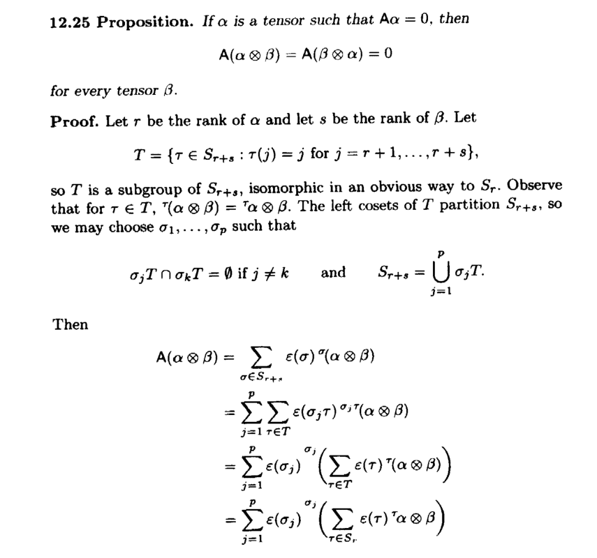

I am reading Andrew Browder's book: "Mathematical Analysis: An Introduction" ... ...
I am currently reading Chapter 12: Multilinear Algebra ... ...

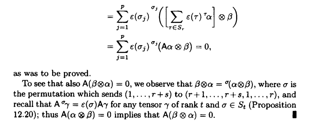

I need some help in order to fully understand the proof of Proposition 12.2 on pages 277 - 278 ... ...Proposition 12.2 and its proof read as follows:
In the above proof by Browder (near the end of the proof) we read the following:
" ... ... To see also that ##A( \beta \otimes \alpha ) = 0##, we observe that ## \beta \otimes \alpha = \ ^{ \sigma }( \alpha \otimes \beta )## where ##\sigma## is the permutation which sends ##(1, \cdot \cdot \cdot , r+s )## to ##(r+1, \cdot \cdot \cdot , r+s, 1 \cdot \cdot \cdot , r )## ... ... "My question ... or more accurately problem ... is that given ##\sigma## as defined by Browder I cannot verify that ##\beta \otimes \alpha = \ ^{ \sigma }( \alpha \otimes \beta )## is true ...My working is as follows:
Let ##\alpha \in \bigwedge^r## and let ##\beta \in \bigwedge^s## ... ...
Then we have ...
##\beta \otimes \alpha (v_1, \cdot \cdot \cdot , v_{ r+s } ) = \beta ( v_1, \cdot \cdot \cdot , v_s ) \alpha ( v_{ s+1 }, \cdot \cdot \cdot , v_{ r+s } )##
and
##\alpha \otimes \beta (v_1, \cdot \cdot \cdot , v_{ r+s } ) = \alpha ( v_1 , \cdot \cdot \cdot , v_r ) \beta ( v_{ r+1 }, \cdot \cdot \cdot , v_{ r+s } )##Now consider ##\sigma## where ...
... ##\sigma## sends ##(1, \cdot \cdot \cdot , r+s )## to ##(r+1, \cdot \cdot \cdot , r+s, 1 \cdot \cdot \cdot , r )##We have
##^{ \sigma } ( \alpha \otimes \beta ) (v_1, \cdot \cdot \cdot , v_{ r+s } )##
##= \alpha \otimes \beta ( v_{ r+1 }, \cdot \cdot \cdot , v_{ r+s }, v_1, \cdot \cdot \cdot , v_r )## ... ... hmm ... this does not appear to be correct ...BUT ... ... if we consider ##\sigma_1## where ...
... ##\sigma_1## sends ##(1, \cdot \cdot \cdot , r+s )## to ##(s+1, \cdot \cdot \cdot , r+s, 1 \cdot \cdot \cdot , s )##
then we have
##^{ \sigma_1 } ( \alpha \otimes \beta ) (v_1, \cdot \cdot \cdot , v_{ r+s } )##
##= ( \alpha \otimes \beta ) ( v_{ s+1 }, \cdot \cdot \cdot , v_{ r+s }, v_1, \cdot \cdot \cdot , v_s )##
##= \alpha ( v_{ s+1 }, \cdot \cdot \cdot , v_{ r+s } ) \beta ( v_1, \cdot \cdot \cdot , v_s )##
##= \beta \otimes \alpha## ...
Given that my working differs from Browder ... I suspect I have made an error ...
Can someone please point out the error(s) in my working ...
Help will be much appreciated ...
Peter
Then we have ...
and

It's possible that what the author means by ##{}^\sigma(\alpha\otimes\beta)## is the converse of what I had assumed.
What is your understanding of what the author wants the ##\sigma## operator to mean? Under the author's definitions, do we have, for a tensor ##\eta## or rank ##m##:
$$({}^\sigma(\eta))(v_1,...,v(m)) = \eta(\sigma(v_1),...,\sigma(v_m))$$
or
$$({}^\sigma(\eta))(v_1,...,v(m)) = \eta(\sigma^{-1}(v_1),...,\sigma^{-1}(v_m))$$
If it's the latter then the proof works - but what you and I have written will need to be rewritten. If not, it doesn't.
or
Hi Andrew ...
Thanks again for your help ...The definition of ##^{\sigma} \alpha## is definition 12.17 on page 274 of Browder and reads as follows:12.17 Definition. Let ##\alpha## be a tensor of rank ##r## and ##\sigma \in S_r##. We define a new tensor ##^{\sigma} \alpha## of rank ##r## by the formula
## ^{\sigma} \alpha ( v_1, \cdot \cdot \cdot , v_r ) = \alpha ( v_{ \sigma(1) }, \cdot \cdot \cdot , v_{ \sigma(r) } ) ##
for all ##v_1, \cdot \cdot \cdot , v_r \in V##
... so it is your first possibility ...
But .. I think that that leaves us with the same problem of a rank ##r## tensor expressed with ##s## input vectors ...
Can you resolve this difficulty ... or is Browder in error with his description of ##\sigma## ... ?Can you please help further ...
Peter
Thanks for that.
Given that definition, I think the author has got a key line the wrong way around in his proof. It doesn't wreck the proof. It just needs correction.
I think, at the bottom, where he wrote
Browder said:
##\beta\otimes\alpha = {}^\sigma(\alpha\otimes\beta)##, where ##\sigma## is the permutation which sends ##(1, ...,r+s)## to ##(r+1, ...,r+s,1,...,r))##
he should have written
"where ##\sigma## is the permutation which sends ##(1, ...,r+s)## to ##(s+1, ...,r+s,1,...,s))##"
I haven't checked it, but I feel pretty confident that that amendment will not derail his proof.
