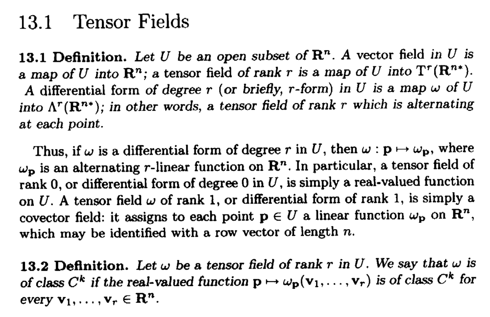

Andrew Browder in his book: "Mathematical Analysis: An Introduction" ... ... defines a differential form in Section 13.1 which reads as follows:
In the above text from Browder we read the following:
" ... ... A differential form of degree ##r## (or briefly an ##r##-form) in ##U## is a map ##\omega## of ##U## into ## { \bigwedge}^r V ( \mathbb{R}^{ n \ast } )## ... ... "In other words if ##\omega## is a differential form of degree ##r## in ##U##, then we have

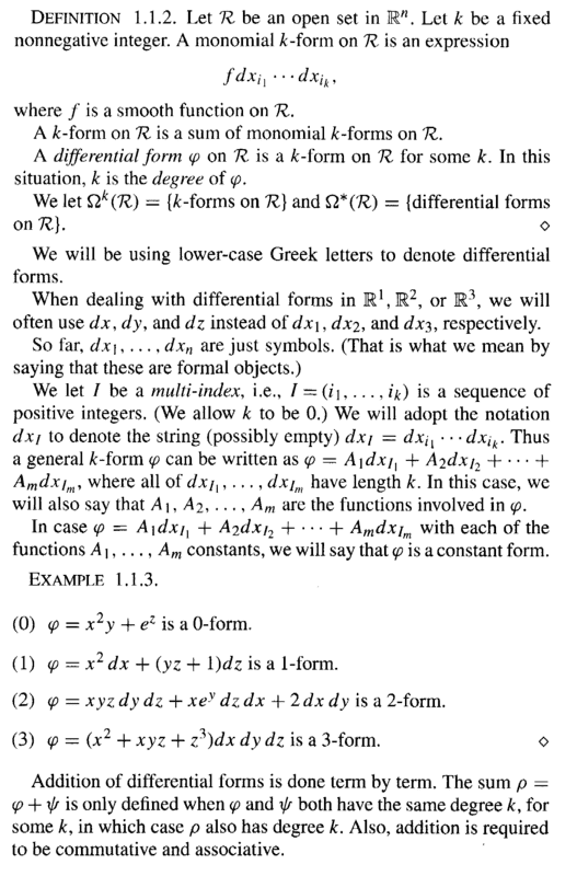

##\omega : p \to \omega_p ( v_1, \cdot \cdot \cdot , v_r )##Browder, unfortunately, gives no example of a differential form ... but I found an introductory example of a ##2##-form on page 6 of Steven Weintraub's book: Differential Forms: Theory and Practice ... the example (Example 1.1.3 (2) ) reads as follows:
##\phi = xyz \text{ dy } \text{ dz } + x e^y \text{ dz } \text{ dx } + 2 \text{ dx } \text{ dy }##
My question is as follows:
How do we interpret Weintraub's example in terms of Browder's definition of a differential form ... and further, how do we translate Weintraub's example into an example in Browder's notation/definition ... ...Help will be much appreciated ... ...

The differential of a function ##f## is the 1-form ##df## such that ##df(v) = df/dt##, where the derivative of ##f## is taken with respect to the curve parameter ##t## such that ##v## is the tangent vector of the curve. A complete basis for 1-forms is given by the differentials of the coordinate functions. These are the ##dx##, ##dy##, and ##dz## in the expression. The products of the differentials is intended as the antisymmetric wedge product, which makes them 2-forms. Since you have three dimensions, there are three [n(n-1)/2] independent such products and the general 2-form is a linear combination of those.

However I am still struggling to understand the explicit link/equivalence between Browder's definition of ##\omega## and Weintraub's example ...
Peter

Weintraub does not write the wedges and only uses notations up to three, which is a bit confusing, as he does not mention (in what you copied) that differential forms are alternating.
Say we have a differential (alternating) ##2-##form ##\omega = xyz (\text{dy} \wedge \text{dz}) + x e^y (\text{dz}\wedge \text{dx}) + 2 (\text{dx} \wedge \text{dy})##. Then Weintraub writes it as ##\varphi = xyz \text{ dy } \text{ dz } + x e^y \text{ dz } \text{ dx } + 2 \text{ dx } \text{ dy }##, but they are the same thing.
