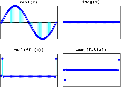

I've written a program that calculates the discrete Fourier transform of a set of data in FORTRAN 90. To test it, I need to "generate a perfect sine wave of given period, calculate the DFT and write both data and DFT out to file. Plot the result- does it look like what you expect analytically?" The problem is I don't understand how to do this. The result from the DFT is an array of length N of complex numbers, so I've taken the absolute value. My problem is with testing it, I don't understand what I'm supposed to plot the result against, and what it should look like.

If the original signal is a function of time, then the DFT will give you a function of frequency.
I would plot the real and the imaginary parts, instead of the absolute value, since the latter could be correct even though your phase wouldn't.

Ok thank you, how do I plot both the real and imaginary parts of an array? I suppose you mean, say an element is x + iy, I'm plotting x vs y for every element? I'm not sure how to go about this.
https://www.ini.uzh.ch/~ppyk/BasicsOfInstrumentation/matlab_help/math/fftgui4.gif
Four-panel plot of a sampled sine wave: top left real(x) shows blue dots tracing one sine cycle with stems; top right imag(x) is a flat line at zero; bottom left real(fft(x)) shows spikes at the two ends and a flat baseline; bottom right imag(fft(x)) shows small blue points near zero with a spike at the right edge.
  • Four-panel plot of a sampled sine wave: top left real(x) shows blue dots tracing one sine cycle with stems; top right imag(x) is a flat line at zero; bottom left real(fft(x)) shows spikes at the two ends and a flat baseline; bottom right imag(fft(x)) shows small blue points near zero with a spike at the right edge.

I assume here fft means fast Fourier transform? I'm not sure if that's different, or if I should be expecting the same result. If so, then now I know what to expect, so thanks :) but I'm still stuck on trying to plot the real components of the array and the complex ones, and whether or not they should be plotted against each other, or if they should both individually be plotted against something else.
Plotting against each other doesn't make any sense to me. Just plot them against their indexes. In the time domain the steps are discrete time steps, and in the frequency domain, they are discrete frequency steps, no?
Thank you, can you just clarify what you mean by their indexes?
Well, discrete functions have indices, no? Discrete functions in the time domain have indices that are some multiple of the time step. Discrete functions in the frequency domain have indices that are some multiple of the frequency step.
