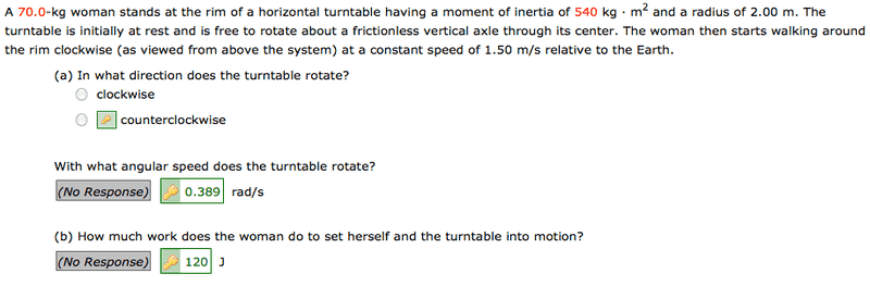

The angular speed of the turntable with a woman on it? Help!
Ok so I understand part a (why it's counterclockwise. τ = Fr = (mg)(2) = (70)(9.8)(2) = +1372)
Part b is where I'm stuck...
This is what I did...
PEinitial + [STRIKE]KEinitial rotational[/STRIKE] = [STRIKE]PEfinal[/STRIKE] + KEfinal rotational
PEinitial = KEfinal rotational
mgh = (1/2)Iω2
(70)(9.8)(2) = (1/2)(540)ω2
1372 = 270ω2
1372/270 = ω2
5.08 = ω2
2.25 rev/s = ω
Convert to rad/s
2.25/2π rad/s = 0.358 rad/s, but the answer is 0.389.
Help! :( Where did I go wrong?
Did the woman change her position in the VERTICAL direction?
Brb in 2 hours!
In the meantime can someone answer my question?

Is angular momentum conserved here?
If the OP is to learn anything then the OP must try to answer the question posted above, i.e. whether the woman changed her position in the vertical direction.
Yes! She maintains a constant speed of 1.50 m/s, so the round table keeps turning (conservation of angular momentum)

The woman is walking on a surface that stays horizontal. You've misunderstood the question.

The total angular momentum of the entire system is conserved regardless of constancy of her speed. This is because there are no external forces acting on the system. How could you use this fact?
1) Conservation of angular momentum (NO EXTERNAL FORCES acting on the system)
Linitial = Lfinal
[STRIKE](Ltable + Lwoman)initial[/STRIKE] = (Ltable + Lwoman)final
0 = (Ltable + Lwoman)final
0 = I1ω1 + I2ω2
-I1ω1 = I2ω2
ω1 = -(I2ω2)/I1
2) Moment of Inertia for the woman (I2)
I2 = mr2
I2 = (70)(22)
I2 = 280
3) Angular Speed of the woman (ω2)
ω = v/r
ω = (1.50)/(2)
ω = 0.75 rad/s
4) Moment of Inertia for the table (I1) - this is given
I1 = 540
5) Plug and chug
ω1 = -(I2ω2)/I1
ω1 = -[(-280)(0.75)]/540
ω1 = 0.389 rad/s
