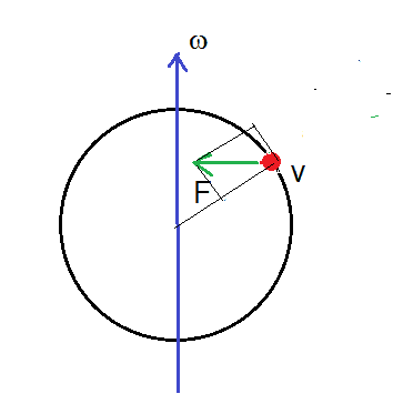

In addition to @Orodruin's explanation: The velocity vector points out of the plane of the picture. The Coriolis force points towards the rotation axis, and it has a radial component (towards the center of Earth), and one in the plane tangent of the Earth surface.
Which, luckily, is exactly what we see here:
Orodruin said:
\vec a_c = \ldots = - 2v\omega [\cos(\theta) \vec e_\theta + \sin(\theta) \vec e_r].
