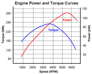

Emre said:
I think we can understand why high RPM launch is very important no matter how much torque you have.
High RPM equates with the most power, you want power to accelerate fast?
From, https://www.quora.com/Why-is-it-tha...hing-a-peak-even-though-the-RPM-is-increasing
From, https://www.google.com/search?safe=...j35i39k1j0i30k1j0i8i30k1j0i24k1.0.mqikaVr3JjI
Also you don't want your wheels to chatter, why do they do that?
Crankshaft's inertia is not even compareble to that of flywheel,actually.
In a given gear,the car accelerates the fastest at torque peak moment.However,you can always do better by downshifting,bringing the RPM to max power.There is only one gear we aren't able to do this,the first gear.So yes,if you downshift or upshift,we want power.
